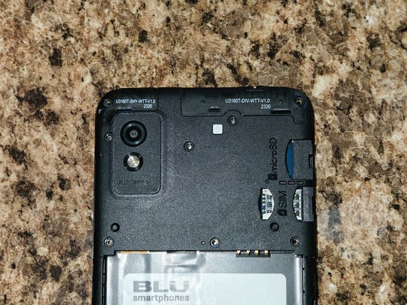

  4. BLU Studio Mini 2023 - Full Disassembly, Top plastics: 手順 4、 2の画像 1 BLU Studio Mini 2023 - Full Disassembly, Top plastics: 手順 4、 2の画像 2
    • Remove the 8 total screws securing the top plastics
    • There are 7 screws, marked in pink
    • A single screw is hidden by a blue sticker, marked in yellow. It's the same type as the ones that were marked in pink
    • Gently pry off the top plastic, it has no adhesive and should pop off with minimal force
