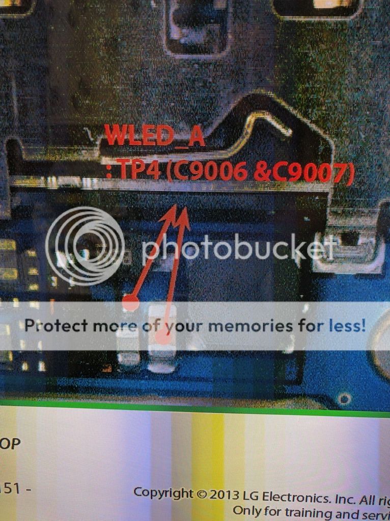

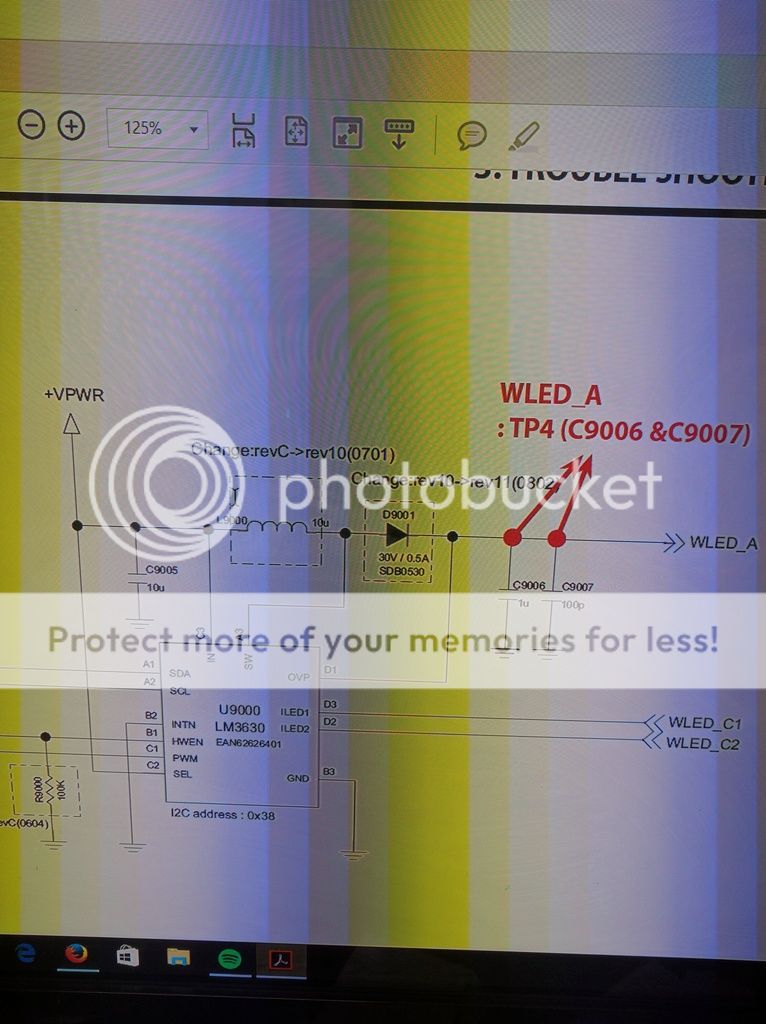

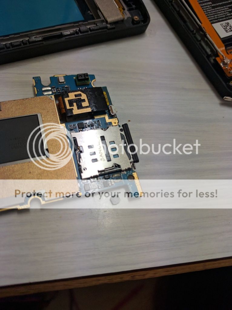

hi my nexus 5 mobile screen is black however the touch still works on it and also i can receive calls through it as well so i thought the flex cable and screen needed replaced so i did that however i still get the same problem, when i was checking over the board today a component was hanging off i have looked at the schematics and have narrowed it down to a coil under the name l9000 however if someone can check i am right i have provided pics below

@ambisingh you are correct. that is L9000 and the rest of your markings are correct as well.

@oldturkey03 Do you know what the vaule of l9000 would be or what that component is called??
さんによる
Looks like a 10u Henry fixed inductor (reference designator "L" indicators that). as for the size you'd have to measure it to get the proper one. Check on here
