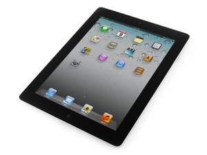

Does the Ipad 2/3 use the same LCD?
Hello my Ifixit friends!
Does the Ipad 2/3 Use the same LCD?
Thanks a lot for your help! :)
/EDIT: I noted Ipad 4 does NOT use the same LCD as neither IP2/3..

Hi
No way, the resolution is different, and the connectors are different.
iPad 2 LCD
iPad 3/4 LCD
Regards.

That's funny--the iPad 2/3 no. But yes, you can use a 3 LCD in a 4.
