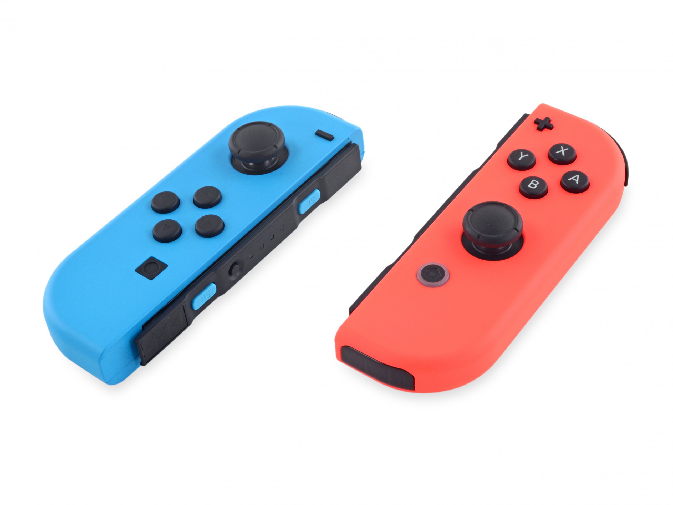

The Nintendo Switch has seen massive success since its launch in 2017, but that doesn’t mean the console didn’t experience issues. Arguably, failing Joy-Cons are one of its biggest pain points.
The specific issue seems to be drifting sticks, mostly with the left Joy-Con. This causes your character or vehicle in a game to drift left or right, even though the joystick is centered and the player isn’t applying any input.
Users have dug into the issue to find the cause, and thanks to this joystick teardown from Reddit user rainbopython, it’s easy to see the contact pads on the joystick’s circuit board wear down over time. The pads are made of a softer material than the metal prongs from the joystick that press down on these pads, accelerating the wear process and causing the joystick to drift, often within a matter of months.

Try Cleaning Debris Out of Your Joy-Con
If you’re up for it, you can disassemble your Joy-Con and clean off any dust or debris that makes its way into the joystick assembly.
We have a Joy-Con repair guide that goes through the process of disassembling the controller, and the joystick teardown from rainbopython gives you a closer look at the contact pads that can be cleaned off to hopefully fix the issue, using a cotton swab and some contact cleaner.
However, as rainbopython notes, cleaning the contact pads is just a temporary fix, as the pads wear down over time, which is likely the culprit for the drifting problem. So if you want your fix to last longer, you’ll need to replace the entire joystick assembly.
Replace the Joystick Entirely
It’s not the most ideal solution, but replacing the joystick assembly is your best bet if you want a properly-working Joy-Con again. (At least until it fails the next time.)
Using our same Joy-Con repair guide linked above, you can disassemble the controller and replace the joystick, using either the traditional option or a hall-effect replacement that is less prone to stick drift. It certainly beats paying $40 for a new Joy-Con.
