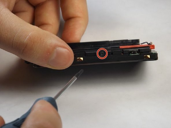

Orient the component so that the battery compartment and camera are facing upwards. Use the #00 Phillips screwdriver to remove the exterior screws that are holding the piece together.
Remove screws from internal component
  • Orient the component so that the battery compartment and camera are facing upwards.
  • Use the #00 Phillips screwdriver to remove the exterior screws that are holding the piece together.
  • There should be screws on both lateral sides of the phone as well as one screw in the top corner to the right of the camera
