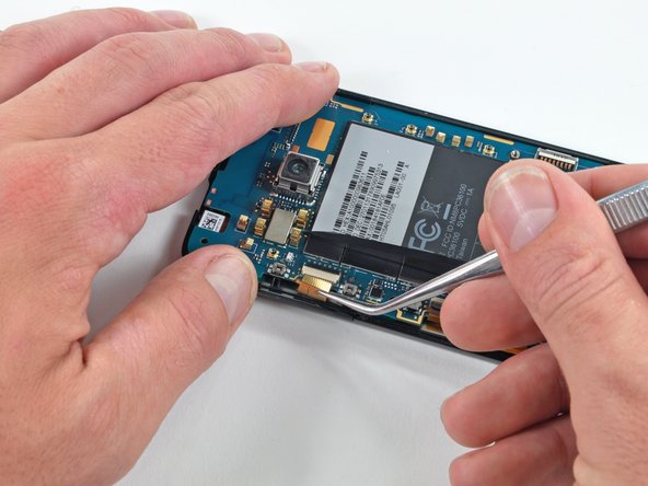

Using the tip of an iPod opening tool, flip up the front-facing camera ribbon cable retaining flap. Be very careful and gentle with these flaps. They are very easy to break or dislodge and equally difficult to reinstall.
  • Using the tip of an iPod opening tool, flip up the front-facing camera ribbon cable retaining flap.
  • Be very careful and gentle with these flaps. They are very easy to break or dislodge and equally difficult to reinstall.
  • Use a pair of tweezers to pull the front-facing camera ribbon cable straight out of its socket.
