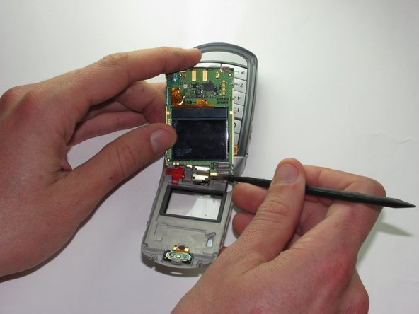

Insert the spudger under the screen and pry the screen forward. Remove the plug on the back of the screen that connects it to the camera.
  • Insert the spudger under the screen and pry the screen forward.
  • Remove the plug on the back of the screen that connects it to the camera.
