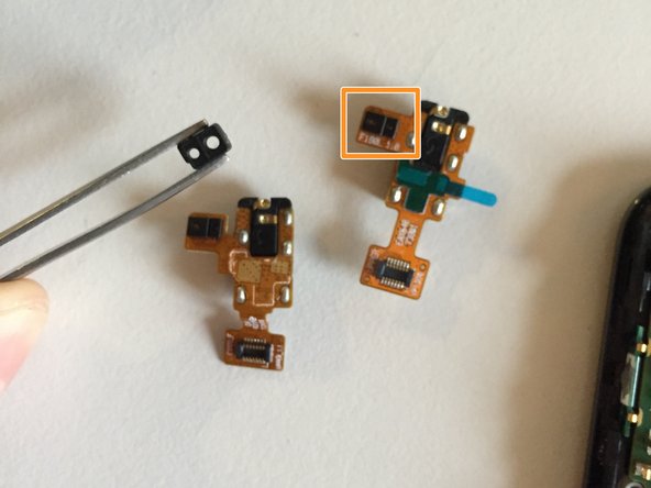

The audio port will likely lift out together with the ambient light sensor rubber cap. Remove the cap from the old part and move it to the new one. Ensure the cap stays in place when installing the new audio port into the phone.
  • The audio port will likely lift out together with the ambient light sensor rubber cap.
  • Remove the cap from the old part and move it to the new one. Ensure the cap stays in place when installing the new audio port into the phone.
