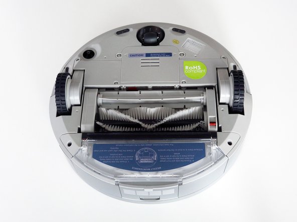

    • Before we get started, turn bObi Pet OFF and flip her over onto a flat surface.
    • Next, remove the dustbin.

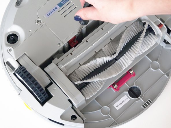

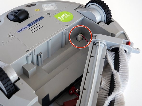

  3. bObi Pet Main Brush Motor  Replacement, Remove the Brush Compartment: 手順 3、 3の画像 1 bObi Pet Main Brush Motor  Replacement, Remove the Brush Compartment: 手順 3、 3の画像 2 bObi Pet Main Brush Motor  Replacement, Remove the Brush Compartment: 手順 3、 3の画像 3
    • Grip the brush compartment and pull down to reveal two screws on a red fastener. Remove them with the screwdriver.
    • Pull the brush compartment up until it is freed from the red fastener.
    • Then, detach the brush compartment and set it aside.

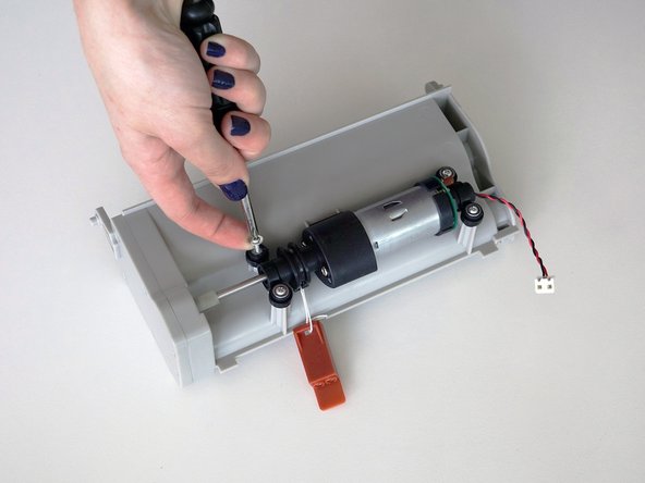

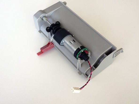

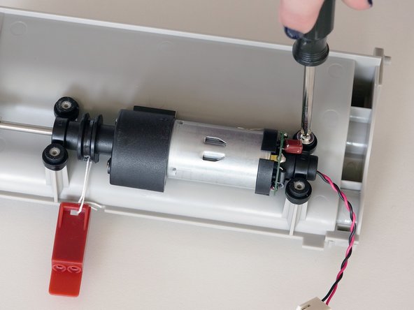

  4. bObi Pet Main Brush Motor  Replacement, Detach the motor: 手順 4、 3の画像 1 bObi Pet Main Brush Motor  Replacement, Detach the motor: 手順 4、 3の画像 2 bObi Pet Main Brush Motor  Replacement, Detach the motor: 手順 4、 3の画像 3
    • The main brush motor is located on the bottom of the brush compartment, the side opposite the main brushes.
    • Remove the 4 screws which secure it.
    • Then lift the motor up.

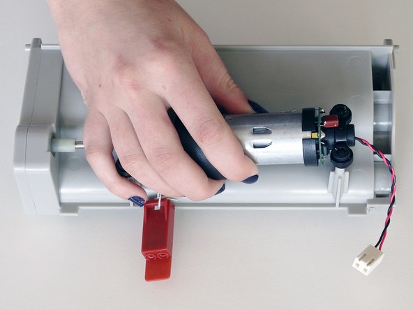

  5. bObi Pet Main Brush Motor  Replacement, Remove the Motor's Stabilizers: 手順 5、 3の画像 1 bObi Pet Main Brush Motor  Replacement, Remove the Motor's Stabilizers: 手順 5、 3の画像 2 bObi Pet Main Brush Motor  Replacement, Remove the Motor's Stabilizers: 手順 5、 3の画像 3
    • Remove the black stabilizer attached to the motor’s circuit plug end.
    • Then slide the motor out.
    • Now you’re ready to install bObi Pet’s new motor.

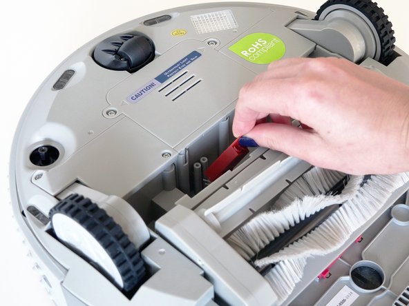

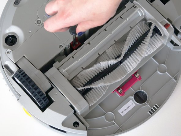

  8. bObi Pet Main Brush Motor  Replacement, Plug in the Main Brushes: 手順 8、 3の画像 1 bObi Pet Main Brush Motor  Replacement, Plug in the Main Brushes: 手順 8、 3の画像 2 bObi Pet Main Brush Motor  Replacement, Plug in the Main Brushes: 手順 8、 3の画像 3
    • Now attach the brush compartment back onto bObi Pet. Plug it in first.
    • Then, replace its red brush fastener on the screw posts on bObi Pet and install the 2 screws.
