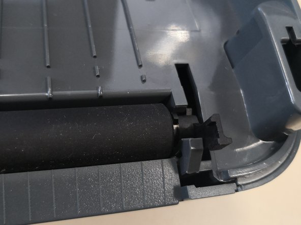

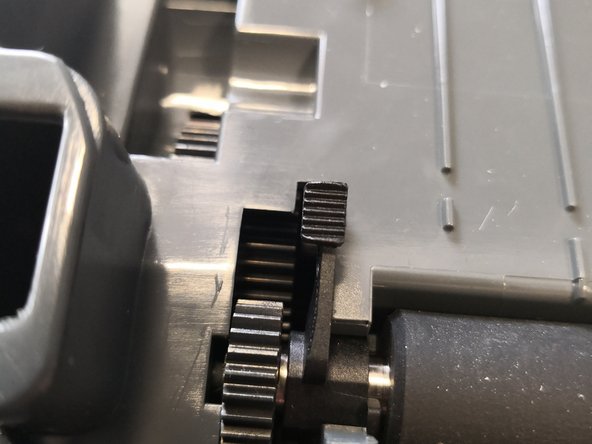

    • Power Off the device and open the main cover
    • locate the 2 tabs on either side of the roller and push them outwards to release them
    • Pull up on both tabs to release the roller from the printer

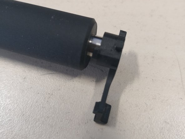

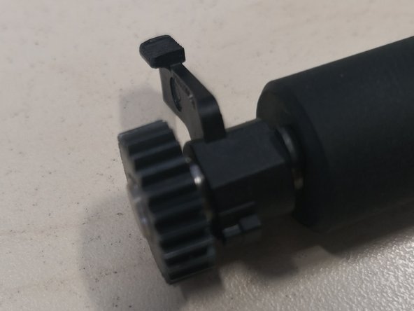

  2. Zebra GK420t Platten Rollers Replacement, Building the New Roller: 手順 2、 3の画像 1 Zebra GK420t Platten Rollers Replacement, Building the New Roller: 手順 2、 3の画像 2 Zebra GK420t Platten Rollers Replacement, Building the New Roller: 手順 2、 3の画像 3
    • The new Roller will be packaged in separate sections in the order that it needs building
    • Starting on the right the shorter side of the roller place 1 tab
    • On the left side of the roller place the other tab and then the cog to secure the tab in place
