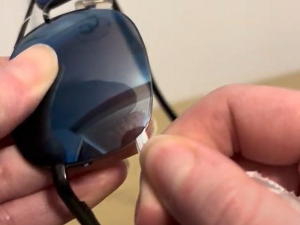

  1. Wire Sunglasses Frame Lens Replacement, Sunglasses Lens: 手順 1、 2の画像 1 Wire Sunglasses Frame Lens Replacement, Sunglasses Lens: 手順 1、 2の画像 2
    • Place the missing lens against the upper rim of the glasses, feel free to fit the bottom wire underneath.

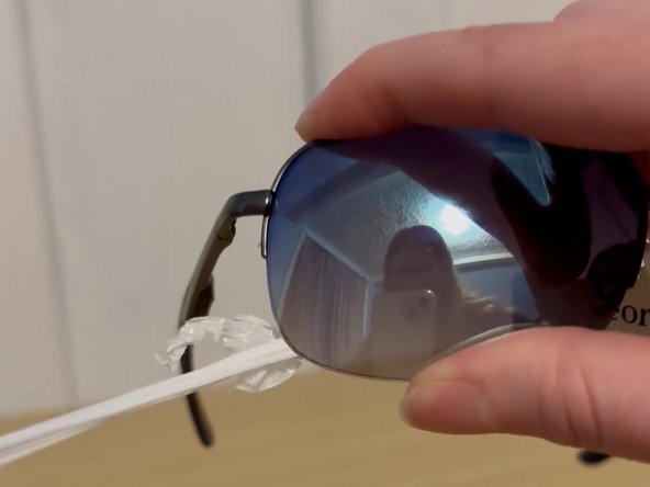

  2. Wire Sunglasses Frame Lens Replacement: 手順 2、 2の画像 1 Wire Sunglasses Frame Lens Replacement: 手順 2、 2の画像 2
    • While holding the frame in position, thread the plastic strip around the metal wire. The strip should sit around halfway through it.

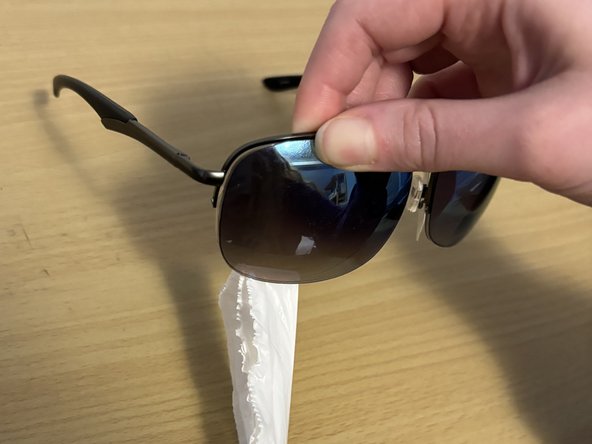

  3. Wire Sunglasses Frame Lens Replacement: 手順 3、 2の画像 1 Wire Sunglasses Frame Lens Replacement: 手順 3、 2の画像 2
    • Using the plastic strip as an anchor, slowly re-fasten the wire underneath the bottom of the frame. Slide the strip from one end of the frame to the other.
    • The lens must remain firmly around the upper rim for the wire to slide underneath.

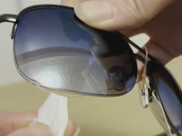

  4. Wire Sunglasses Frame Lens Replacement: 手順 4、 2の画像 1 Wire Sunglasses Frame Lens Replacement: 手順 4、 2の画像 2
    • Once the wire is under the frame, use the plastic strip to gently adjust the wire as needed.

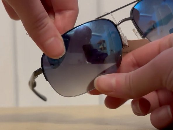

  5. Wire Sunglasses Frame Lens Replacement: 手順 5、 2の画像 1 Wire Sunglasses Frame Lens Replacement: 手順 5、 2の画像 2
    • Once you are done, begin to remove the plastic strip from the frame.
    • Gently tug at one end of the strip to remove it from between the lens and the wire.
  6. Wire Sunglasses Frame Lens Replacement: 手順 6、 2の画像 1 Wire Sunglasses Frame Lens Replacement: 手順 6、 2の画像 2
    • Ensure the lens is secured by gently pushing it.
    • If the lens is still loose or needs to be re-adjusted, take the lens out and start again from Step 1.
