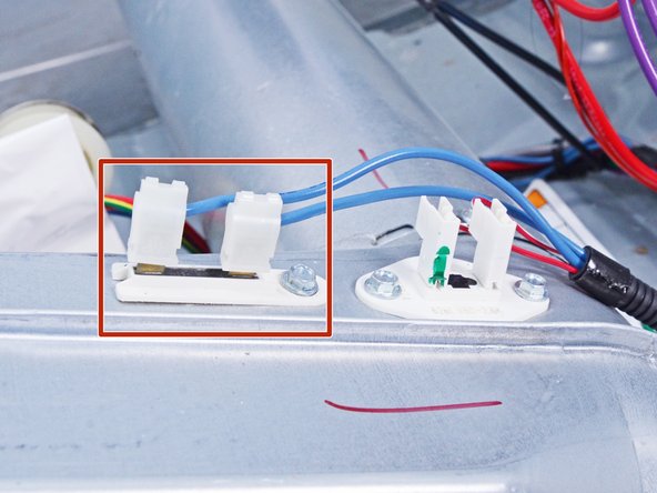

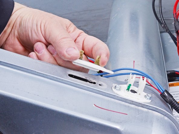

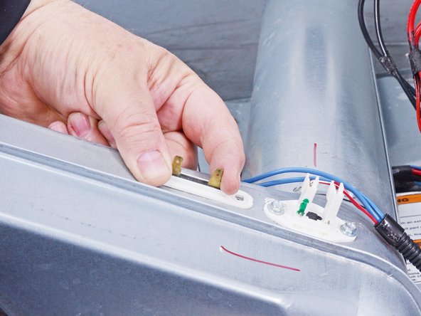

  41. Whirlpool WED87HED Dryer Thermal Fuse Testing and Replacement, Thermal fuse information: 手順 41、 2の画像 1 Whirlpool WED87HED Dryer Thermal Fuse Testing and Replacement, Thermal fuse information: 手順 41、 2の画像 2
    • The following steps show how to replace the thermal fuse.

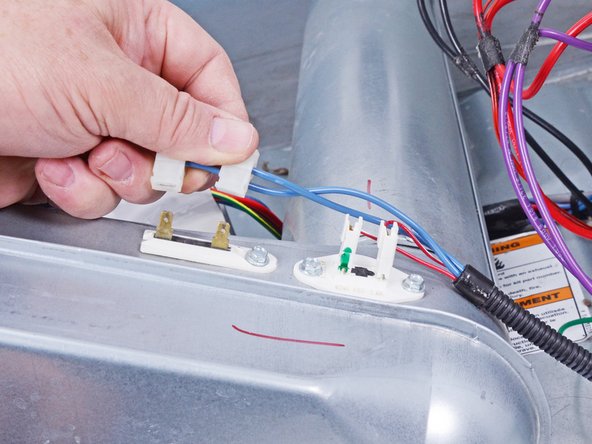

  42. Whirlpool WED87HED Dryer Thermal Fuse Testing and Replacement, Disconnect the thermal fuse: 手順 42、 3の画像 1 Whirlpool WED87HED Dryer Thermal Fuse Testing and Replacement, Disconnect the thermal fuse: 手順 42、 3の画像 2 Whirlpool WED87HED Dryer Thermal Fuse Testing and Replacement, Disconnect the thermal fuse: 手順 42、 3の画像 3
    • Disconnect the two spade connectors attached to the thermal fuse.

  43. Whirlpool WED87HED Dryer Thermal Fuse Testing and Replacement, Test the thermal fuse: 手順 43、 1の画像 1
    • If you aren't sure how to use a multimeter, take a look at this guide.
    • Set your multimeter to the ohms (Ω) setting. If your meter has more than one scale for ohms, set it to (Rx1).
    • Touch the probes to the contacts on the thermal fuse. The reading should be less than one Ω. The photo shows the reading for a good thermal fuse.
  44. Whirlpool WED87HED Dryer Thermal Fuse Testing and Replacement, Unfasten the thermal fuse: 手順 44、 3の画像 1 Whirlpool WED87HED Dryer Thermal Fuse Testing and Replacement, Unfasten the thermal fuse: 手順 44、 3の画像 2 Whirlpool WED87HED Dryer Thermal Fuse Testing and Replacement, Unfasten the thermal fuse: 手順 44、 3の画像 3
    • Use a 1/4 inch nut driver to remove the 12.9 mm‑long sheet metal screw securing the thermal fuse.
    • Slightly lift the screw end of the fuse first and then slide the tab out of the mounting hole.
    • Lift the thermal fuse out of the mounting hole and replace it.
  45. Whirlpool WED87HED Dryer Thermal Fuse Testing and Replacement, Remove the thermal fuse: 手順 45、 2の画像 1 Whirlpool WED87HED Dryer Thermal Fuse Testing and Replacement, Remove the thermal fuse: 手順 45、 2の画像 2
    • Lift the thermal fuse out of the mounting hole and remove it.
