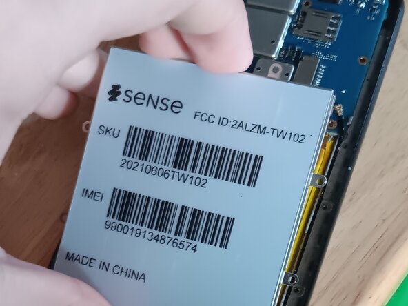

    • Remove the back of the phone. This can be done with your hands.
    • Remove the screws to remove the second layer of protection, and the battery cover.
    • Be careful when taking off the second layer. The fingerprint sensor needs to be unplugged. Lift the cover a bit, unplug and sensor and keep going. Do not be forceful.

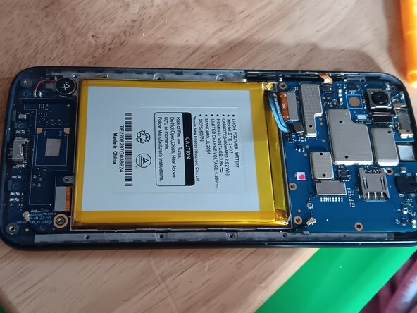

    • Take off the battery cover, you can do this with your hands.
    • Be CAREFUL! Puncturing the battery can result in an explosion and/or fire. Continue at your own risk.
    • The battery has a very strong adhesive. Go slow and be patient so you don't puncture the battery.
終わりに
Put the screws all back and place and everything should be simple to put back together.
