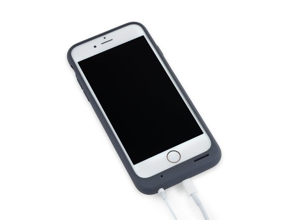

    • The back of the battery case boasts its most important feature: an iPhone 4 backpack!
    • Jk...Probably.
    • While the Smart Battery needs its own external Lightning connector to charge and pass data through to the iPhone within, 3.5 mm headphone jack connectivity is provided in the form of...a hole.
    • As expected, the pass-through hole is perfectly sized for your iPhone's included Apple Earpods.
    • However, for anything bigger, you'll need some sort of adapter. No fancy studio-size jacks for this pack.

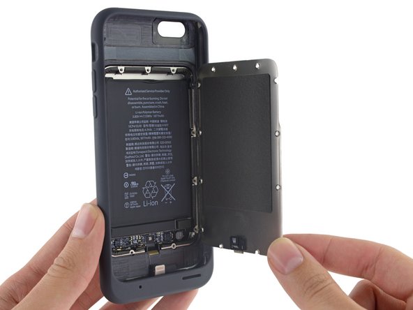

    • This metal plate is a handy door into the battery compartment, and serves to both stiffen the case and protect the battery.
  7. Smart Battery Case Teardown: 手順 7、 3の画像 1 Smart Battery Case Teardown: 手順 7、 3の画像 2 Smart Battery Case Teardown: 手順 7、 3の画像 3

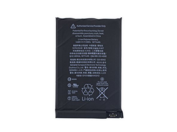

    • Sweet, a battery connector!
    • First things first, we disconnect the battery to prevent accidental shorts or discharges. Always nice to see a battery with a connector like this, so we don't have to bust out the soldering iron.
    • The battery is very strongly adhered in place—probably so it can help stiffen the case to protect its precious cargo—your brand new iPhone 6s.
    • With 7.13 Whr (1877 mAh at 3.8 V) capacity, this battery more than doubles your iPhone 6s (6.55 Whr) capacity.
    • Although if raw power is what you're after, there are plenty of other options, with nearly double the power of the Smart Battery Case.

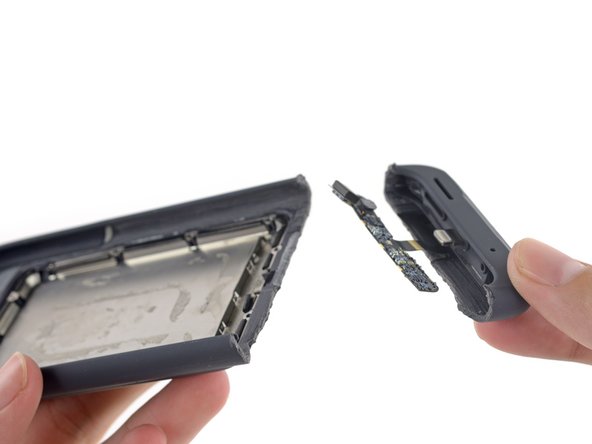

  9. Smart Battery Case Teardown: 手順 9、 3の画像 1 Smart Battery Case Teardown: 手順 9、 3の画像 2 Smart Battery Case Teardown: 手順 9、 3の画像 3

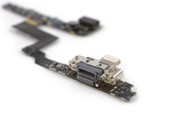

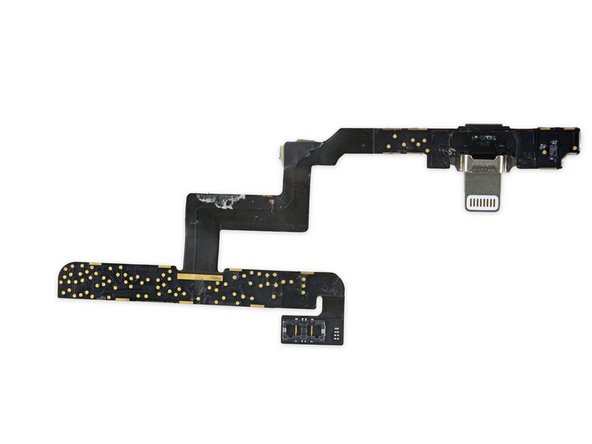

    • We're free! After some dedicated snipping, that had us harkening back to teardowns of yore, we extricate the parts that make this battery Smart.
    • The two Lightning connectors are housed on the same board, with its connecting cable wrapped around a plastic frame.

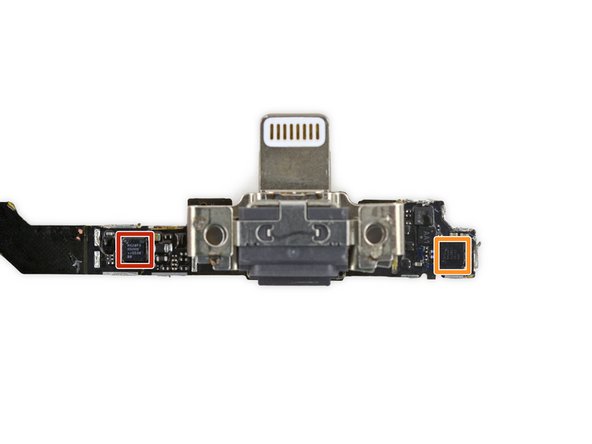

  10. Smart Battery Case Teardown: 手順 10、 3の画像 1 Smart Battery Case Teardown: 手順 10、 3の画像 2 Smart Battery Case Teardown: 手順 10、 3の画像 3

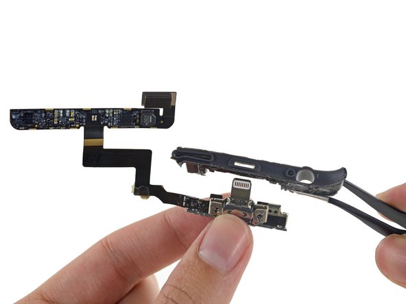

    • For such a Smart battery, it looks like most of the brains probably live in software on your iPhone. We only find some rudimentary ICs inside:
    • NXP Semiconductor NX20P3 load switch, also found in Lightning to USB cables
    • NXP Semiconductor 1608A1 (CBTL1608) charging IC

So it's a workaround for all the dead phones that can't charge because of U2 chip failure from non-Apple charger usage. Make and sell an external U2 chip-on-a-backpack to provide your phone with an externally chargeable battery. Way to spin that one Apple. Nice save.
jessabethany - 返信
The phone still uses it's own charging IC, this IC is most likely only used for charging the battery in the case and feeding battery charge data (from the Ti chip in the base of the battery) back via the lightning port.
Slot1gamer -
