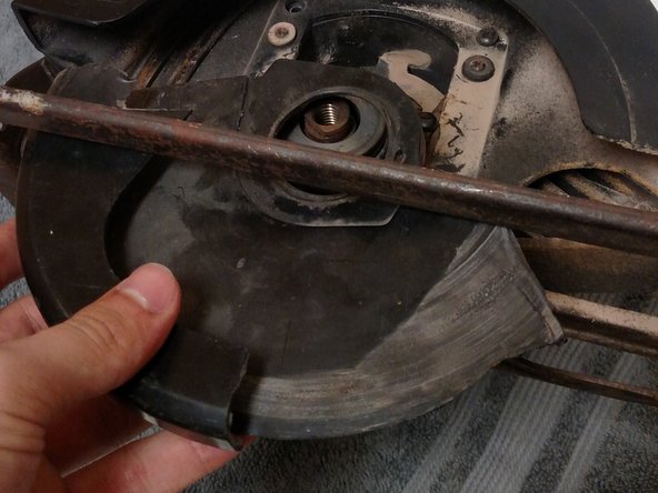

  1. Sears Craftsman 315.109020 Blade/ Blade Cover Replacement, Blade/ Blade Cover: 手順 1、 2の画像 1 Sears Craftsman 315.109020 Blade/ Blade Cover Replacement, Blade/ Blade Cover: 手順 1、 2の画像 2
    • Although this is not a difficult fix, it can definitely make a mess.
    • Lay down a dirty towel or work rag and place the saw on top of the towel.
    • Handle the saw with care and avoid placing your hands on or near the blade when possible.
  2. Sears Craftsman 315.109020 Blade/ Blade Cover Replacement: 手順 2、 3の画像 1 Sears Craftsman 315.109020 Blade/ Blade Cover Replacement: 手順 2、 3の画像 2 Sears Craftsman 315.109020 Blade/ Blade Cover Replacement: 手順 2、 3の画像 3
    • Use the crescent wrench to remove the hex washer head screw and the washer.
    • Gently lift the blade up and pull it off of the internal threaded shaft.
    • If the hex washer head screw, or the entire blade spins as you turn the wrench, a quick jerk of the crescent wrench should loosen the screw.
    • Although many screws loosen in the clockwise direction, the hex washer head screw on this circular saw loosens in the counter-clockwise direction.
  3. Sears Craftsman 315.109020 Blade/ Blade Cover Replacement: 手順 3、 2の画像 1 Sears Craftsman 315.109020 Blade/ Blade Cover Replacement: 手順 3、 2の画像 2
    • Lift up on the blade cover until it unsnaps from the washer.
    • The blade cover will come off easier if the bulk of the cover is facing away from the saw.
