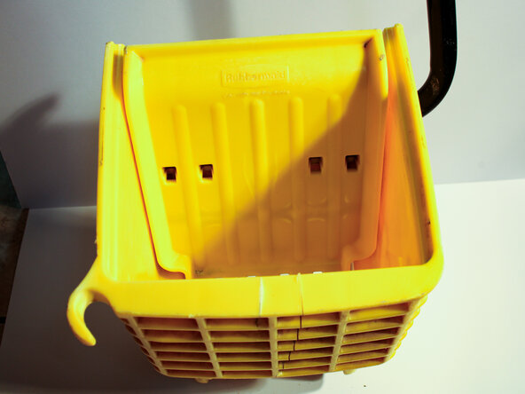

      • Place the side press bucket on a sturdy, solid surface, ensuring that it sits flat.
      • Tilt the bucket forward so the front is resting on the floor or solid surface you're working on, and the lever is facing you.
      • Check that it is secure before you begin working.

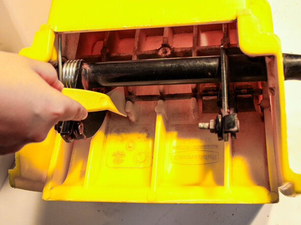

      • Use a #4 flathead screwdriver to apply firm, controlled pressure against the pivot rod to pry it out of its socket.
      • Keep a firm grip on the tool as the rod releases so it doesn't slip, and keep your fingers clear of the rod's path.
