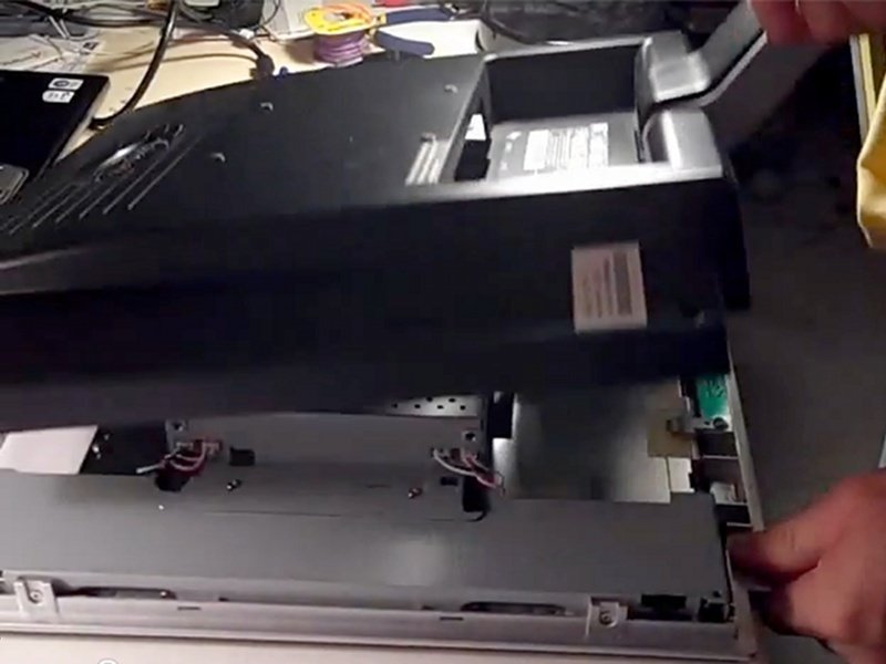

    1. Repairing an LCD Display with failed capacitors, Failed Capacitors: 手順 1、 1の画像 1
      • These steps are as generic as possible, since most LCD displays use a similar design. However, you will need to think carefully about how to take the display apart so you can put it back together, and have it still work!
      • The images are from Repair ViewSonic VX924 LCD Monitor Blinking Green power Button (youtube). You should watch it through once to get an idea for what it's like.
      • First, remove the plastic back of the monitor. The stand/pedestal may be attached by screws, or the back and the stand may all be one unit.
      • Keep the screws you removed with the plastic back. That way they won't get mixed up with the screws you take out of the internal parts.
      • There is also probably some sort of snap-on device molded into the plastic back.
      • In the video, a piece of steel is used. A screwdriver or a piece of strong, flat plastic can also do the job.
      • Snapping the back off should take some strength; however, too much force will permanently damage the plastic.
      • Start with very little force and poke the edges of the back. If one corner moves easily but another corner seems solid, then you may have missed a screw. Gradually increase the force you are using until the snaps come off.

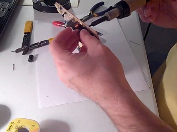

    4. Repairing an LCD Display with failed capacitors: 手順 4、 1の画像 1
      • You can get replacement capacitors from Mouser, Digi-key, or Arrow, or a local electronics parts store.
      • Be sure to match all the requirements:
      • Capacity (micro Farads)
      • Voltage (V)
      • Temperature Rating (C)
      • Capacitor Diameter (mm)
      • Obviously, the manufacturer is not something you need to match.
      • You can go over on capacitor ratings to some extent so the monitor has more of a safety level when in use and less likey to blow to voltage. *this can be bad if the capacitor is failing due to over voltage, sometimes the cap is like a surge protector because it fails open.
      FixBotに聞いてみる
      コメントを追加
      • Match the capacitor diameter in mm.
      FixBotに聞いてみる
      コメントを追加
      • Use a screwdriver or piece of metal to short across the legs of the old capacitors, while they are still in the board. This will "short out" any remaining power left in them so they don't spark or shock you while you do the repair.
      • Using a soldering iron, remove the old capacitors. Then solder in the new ones.
      • Replace the board and screw it into place.
      • Replace all the cables that you removed.
      • If you feel brave, you may want to test the display before putting the plastic back on.
      FixBotに聞いてみる
      コメントを追加
