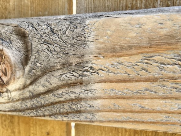

  1. Repair and Extend the Life of Weathered Wood Railing, Repair and Extend the Life of Weathered Wood Railing: 手順 1、 1の画像 1
    • First, you will want to prep the wood railing and surrounding area.
    • You can use a hose to rinse, followed by a cloth if needed. Let the wood dry before proceeding to next step.

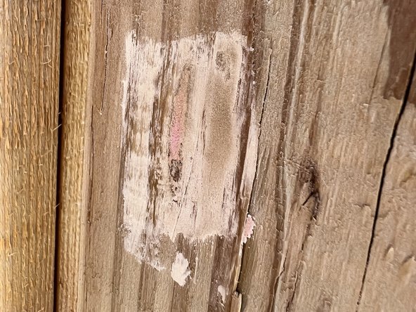

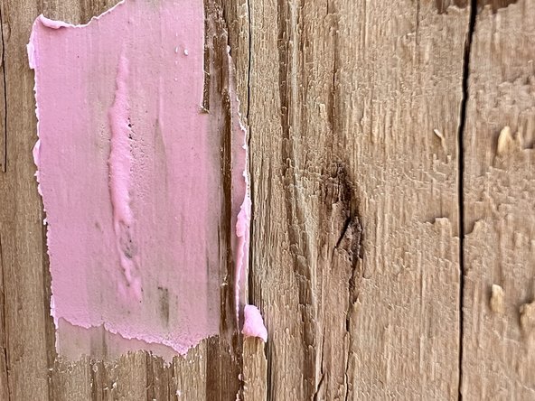

  3. Repair and Extend the Life of Weathered Wood Railing: 手順 3、 2の画像 1 Repair and Extend the Life of Weathered Wood Railing: 手順 3、 2の画像 2
    • Fill in holes for both nails and wood imprfections/damage.
    • You can fill holes with an exterior wood filler. Simply just use your finger or a putty knife. Fill space completely. It is okay to have excess, as you will sand it in the next step.
    • Why fill in holes? Filling in holes can protect imperfections in wood where weather may decay the integrity of the wood faster. Additionally, filing in the holes provides a cleaner look when finished.
  4. Repair and Extend the Life of Weathered Wood Railing: 手順 4、 3の画像 1 Repair and Extend the Life of Weathered Wood Railing: 手順 4、 3の画像 2 Repair and Extend the Life of Weathered Wood Railing: 手順 4、 3の画像 3
    • Sand the wood and the areas where you used wood filler.
    • Take your sanding paper or sanding block as shown, and sand the wood in a circular motion.
    • You do not need it perfectly smooth, but ensure any wood filler is flush with the wood itself.

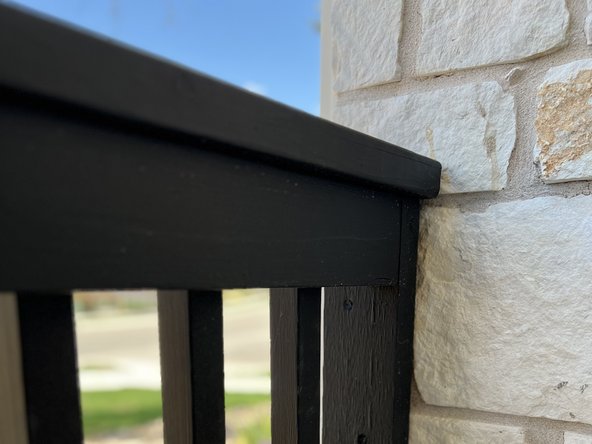

  7. Repair and Extend the Life of Weathered Wood Railing: 手順 7、 2の画像 1 Repair and Extend the Life of Weathered Wood Railing: 手順 7、 2の画像 2
    • Lastly, it is time to paint or stain your railing.
    • You will want to pour your paint or stain into a paint pail. This will make it easier and more efficient when using a paint brush.
    • Take your brush and do short-to-medium strokes in the direction of the wood grain. This will provide a smooth application. Your paint strokes should go from left to right, or right to left.
    • Please note, paint and stains can be toxic. Do not consumer or ingest.
    • Paint and stains can be difficult to clean up if spilled or you get on a surface not indented to receive the paint or stain. Take your time.
    • You can always do another layer of paint or stain. It is best to apply a light coat of paint or stain first. You can always go back to areas needing better coverage if needed.
    • Once all of the wood railing has either been painted or stained, you are done! Let dry for a couple of hours before touching.
