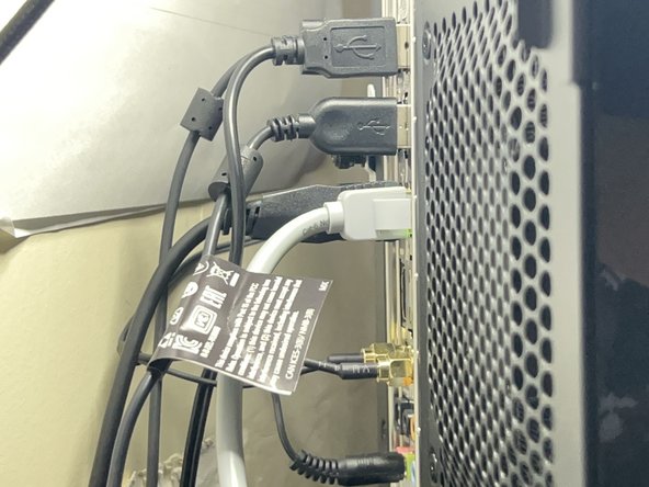

  1. Redragon K552 Key Switch Replacement, Key Switch: 手順 1、 3の画像 1 Redragon K552 Key Switch Replacement, Key Switch: 手順 1、 3の画像 2 Redragon K552 Key Switch Replacement, Key Switch: 手順 1、 3の画像 3
    • Unplug the keyboard from the computer.
    • Because this keyboard does not use a detachable cable, you will have to detach the cable from the PC directly.
    • The location of the cable depends on how you had installed the keyboard into the PC. (In my case, I have it installed on the rear of my PC next to my ethernet cable).
    • RGB lights indicate that power is running through the keyboard.
    • Make sure that no power is running through the keyboard during the replacement process.

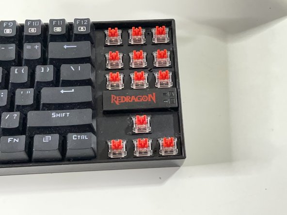

  2. Redragon K552 Key Switch Replacement: 手順 2、 3の画像 1 Redragon K552 Key Switch Replacement: 手順 2、 3の画像 2 Redragon K552 Key Switch Replacement: 手順 2、 3の画像 3
    • Align the keycap puller to the keycap.
    • Use the keycap puller to pull out all the keycaps from the keyboard.

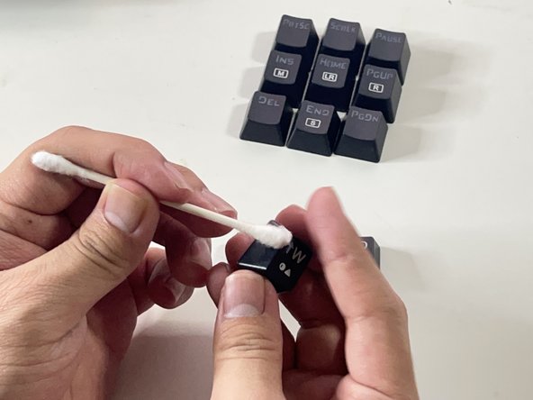

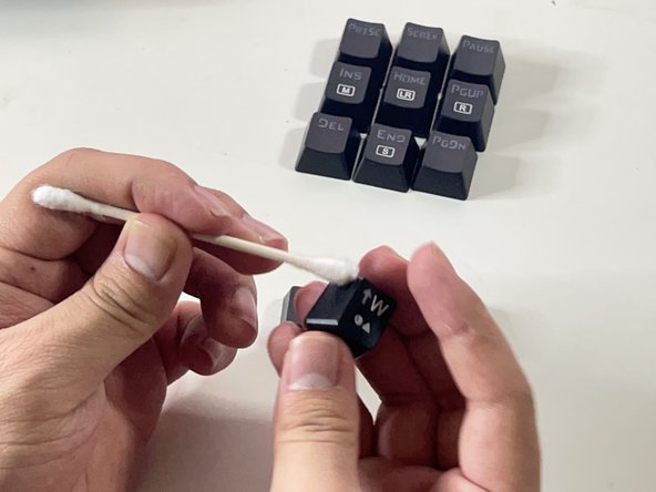

  3. Redragon K552 Key Switch Replacement: 手順 3、 3の画像 1 Redragon K552 Key Switch Replacement: 手順 3、 3の画像 2 Redragon K552 Key Switch Replacement: 手順 3、 3の画像 3
    • Dip cotton swabs into a bottle of rubbing alcohol solution.
    • Clean the keycaps using the cotton swabs.

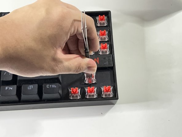

  5. Redragon K552 Key Switch Replacement: 手順 5、 3の画像 1 Redragon K552 Key Switch Replacement: 手順 5、 3の画像 2 Redragon K552 Key Switch Replacement: 手順 5、 3の画像 3
    • Align the switch puller with the faulty key switch.
    • Pull the faulty key switch straight up from the keyboard.
