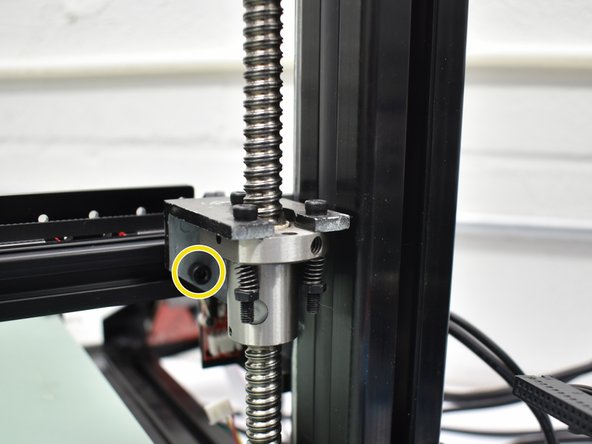

    • Using a 8mm open end wrench, loosen the bottom inner wheel eccentric locknut. Back it off a few turns.
    • Using a 7mm closed end wrench, hold the nylock nut on the front of the X/Z bracket and loosen the eccentric wheel shaft with the M2.5 hex.
    • Fully remove both lower inner wheels. They will not be used.
    • 3 points is superior to 4 in this case.

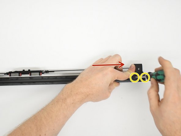

    • Install the X Axis Idler Assembly by aligning the T nuts parallel to the slot and pushing it in until it stops. With an M3 hex, run the screws until they start to tighten but leave final tightening for later.
    • If you have difficulty, loosen the M4 cap screws a couple turns to give clearance for the T nuts to fit easier.

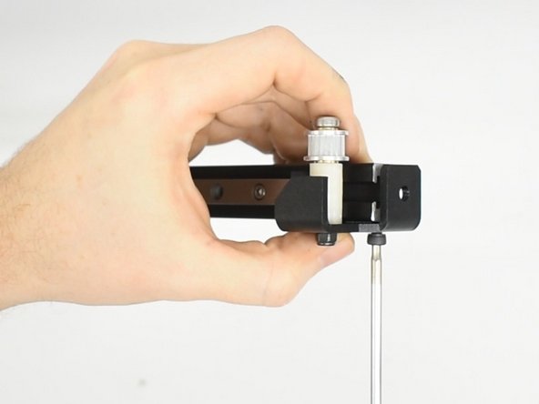

    • The belt should be slightly loose at this point.
    • Loosen the bolts to the X Idler assembly and while pushing it away from the frame, tighten the screws. This step can be repeated once on the machine to hold things more securely and final tension the belt.
