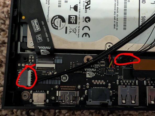

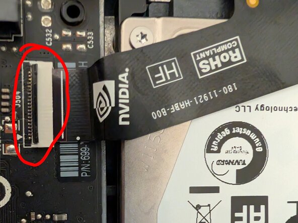

  4. Nvidia Shield TV 1st Generation Hard Drive Replacement: 手順 4、 2の画像 1 Nvidia Shield TV 1st Generation Hard Drive Replacement: 手順 4、 2の画像 2
    • Gently lift the black tab until vertical as shown here. Then pull out the ribbon cable
    • Carefully remove these two cables
  5. Nvidia Shield TV 1st Generation Hard Drive Replacement: 手順 5、 3の画像 1 Nvidia Shield TV 1st Generation Hard Drive Replacement: 手順 5、 3の画像 2 Nvidia Shield TV 1st Generation Hard Drive Replacement: 手順 5、 3の画像 3

This guide completely skips over the details on how to disconnect the cables. This is by far the trickiest part of this operation. The fact that the commenter above tore his SATA cable is proof that crucial steps of this procedure are missing!
ctphillips - 返信

How on earth do you disconnect the flat SATA cable from the motherboard safely?
Tobias Biehl - 返信
