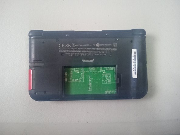

    • Flip the 3DS XL upside down.
  2. Nintendo 3DS XL Hinge/Midframe Replacement: 手順 2、 1の画像 1
    • Remove the two 4.2 mm screws from the back cover using a Phillips #00 screwdriver.

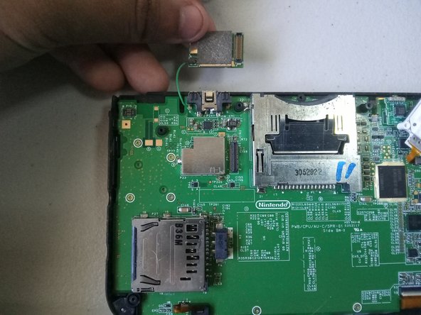

  10. Nintendo 3DS XL Hinge/Midframe Replacement: 手順 10、 2の画像 1 Nintendo 3DS XL Hinge/Midframe Replacement: 手順 10、 2の画像 2
    • Use your fingers to carefully disconnect the small green rectangle (network board).

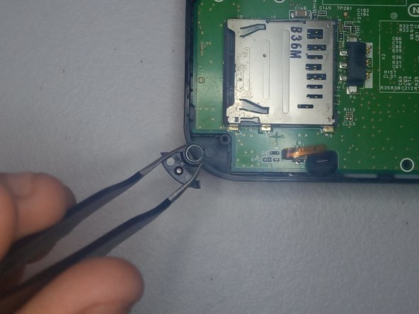

    • On the bottom right corner, remove the small plastic piece using a pair of tweezers.
  13. Nintendo 3DS XL Hinge/Midframe Replacement: 手順 13、 2の画像 1 Nintendo 3DS XL Hinge/Midframe Replacement: 手順 13、 2の画像 2
    • On the bottom left corner, remove the small plastic piece using a pair of tweezers.

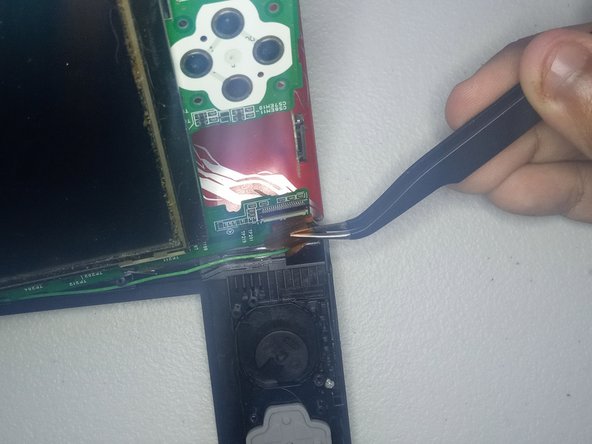

  14. Nintendo 3DS XL Hinge/Midframe Replacement: 手順 14、 2の画像 1 Nintendo 3DS XL Hinge/Midframe Replacement: 手順 14、 2の画像 2
    • With caution yet with slight force, use a pair of tweezers to pull and disconnect the ribbon cable from the latch on the top right corner.

    • Use your fingers to disconnect the green rectangle (network board) from the small green cable.
