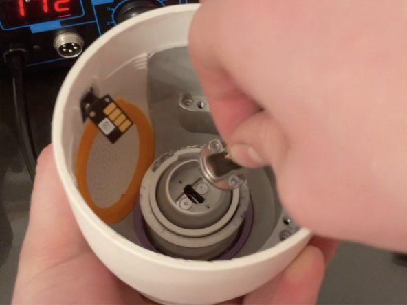

    2. Nest IQ Outdoor Camera Module Disassembly, Open camera seal: 手順 2、 3の画像 1 Nest IQ Outdoor Camera Module Disassembly, Open camera seal: 手順 2、 3の画像 2 Nest IQ Outdoor Camera Module Disassembly, Open camera seal: 手順 2、 3の画像 3
      • This step requires significant force, and has a chance of damaging your device. It takes around 10-minutes of creating gaps and prying to get it off. Perform at your own risk!
      • Carefully insert an iFixit "Jimmy" Tool (flat flexible steel blade) between the hard white plastic housing and edge of the LED light ring.
      • Pry the "Jimmy" tool slightly sideways and insert an iFixit "Metal Spudger" into the gap created. Slide it down inside the housing around half an inch.
      • Use the metal spudger to pry carefully slowly working your way in a circle around the LED Light ring to attempt to slowly work it backwards out of the housing.
      • There is glue holding down the led light ring, so it might take some decent force to pry it, (see third photo).
      • The LED Ring is sealed in place tightly using a rubber gasket, (see photo in next step).

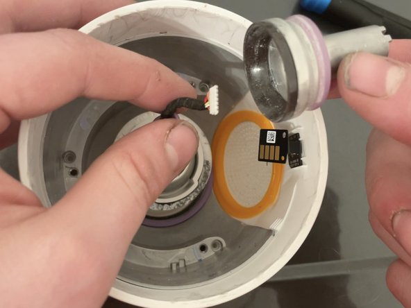

    3. Nest IQ Outdoor Camera Module Disassembly, Remove the LED Ring: 手順 3、 3の画像 1 Nest IQ Outdoor Camera Module Disassembly, Remove the LED Ring: 手順 3、 3の画像 2 Nest IQ Outdoor Camera Module Disassembly, Remove the LED Ring: 手順 3、 3の画像 3
      • Verify all connectors are unplugged before continuing with this guide.
      • Take care prying as there are three ribbon cables attached to the led light ring. Two for microphones, and one for the status LED. They are connected at the Camera Module and the components are lightly attached using some double-sided tape to the LED Light Ring.

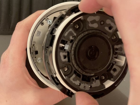

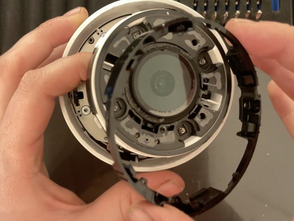

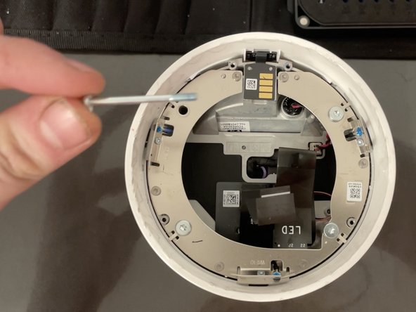

    4. Nest IQ Outdoor Camera Module Disassembly, Remove plastic camera securing ring: 手順 4、 3の画像 1 Nest IQ Outdoor Camera Module Disassembly, Remove plastic camera securing ring: 手順 4、 3の画像 2 Nest IQ Outdoor Camera Module Disassembly, Remove plastic camera securing ring: 手順 4、 3の画像 3
      • Remove each of the four screws securing the plastic ring that is holding down the camera module.
      • Pull the camera module upwards, and remove the black ring from around it by pulling it upward and over the camera module.
      • Be careful not to knock into the metal wifi "fins" that stick up right next to where the black plastic ring sits. If things feel stuck, pause and verify it is not caught up.
      • Reminders
      • 4 x 4.5(?)mm Torx T5 screws

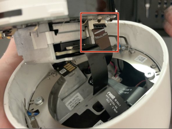

    5. Nest IQ Outdoor Camera Module Disassembly, Unplug LED ZIF Connector: 手順 5、 3の画像 1 Nest IQ Outdoor Camera Module Disassembly, Unplug LED ZIF Connector: 手順 5、 3の画像 2 Nest IQ Outdoor Camera Module Disassembly, Unplug LED ZIF Connector: 手順 5、 3の画像 3
      • Lift the camera module up and out of the housing.
      • Using your fingernail pull down on the black portion of the ZIF connector to flip it into the down position.
      • Slide the LED ribbon cable out of the ZIF connector.
      • You should not have to use ANY force at all to remove the ribbon cable. If you find yourself using force, pause and verify you have flipped down the ZIF connector properly.

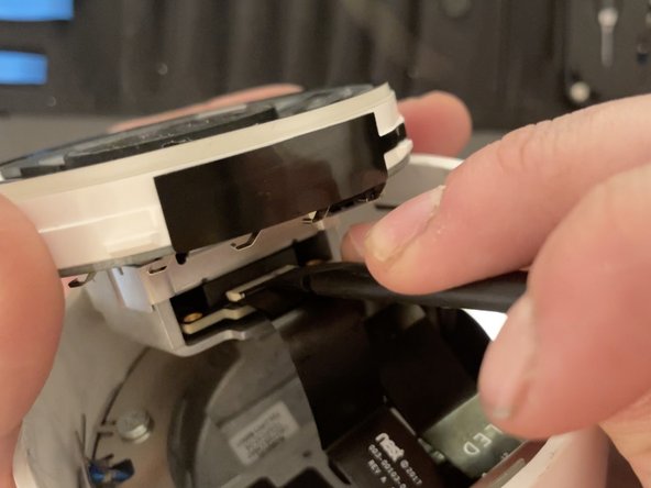

    6. Nest IQ Outdoor Camera Module Disassembly, Unplug the Camera: 手順 6、 3の画像 1 Nest IQ Outdoor Camera Module Disassembly, Unplug the Camera: 手順 6、 3の画像 2 Nest IQ Outdoor Camera Module Disassembly, Unplug the Camera: 手順 6、 3の画像 3
      • Using a flat plastic spudger push upwards on the black portion of the ZIF connector to flip it into the up position.
      • Slide the camera ribbon cable out from the connector.

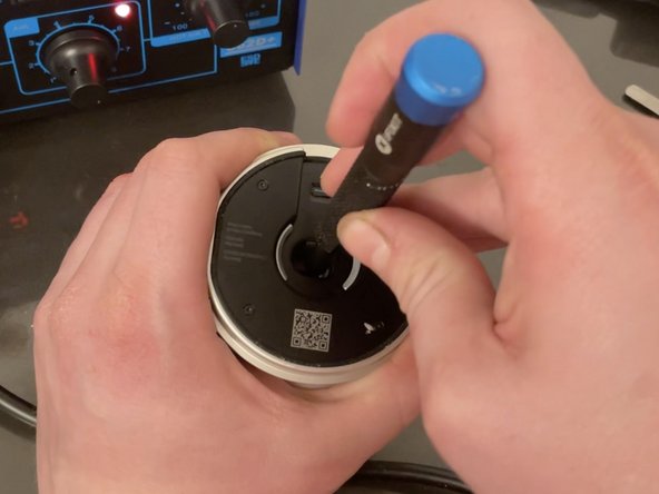

    9. Nest IQ Outdoor Camera Module Disassembly, Unplug power connector: 手順 9、 2の画像 1 Nest IQ Outdoor Camera Module Disassembly, Unplug power connector: 手順 9、 2の画像 2
      • Using your fingers unplug the power connector by gently pulling upwards on the cable until the connector comes out of its socket.

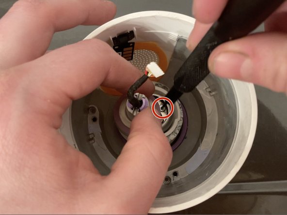

    10. Nest IQ Outdoor Camera Module Disassembly, Unplug speaker connector: 手順 10、 2の画像 1 Nest IQ Outdoor Camera Module Disassembly, Unplug speaker connector: 手順 10、 2の画像 2
      この手順で使用する道具:
      • Unplug the speaker connector next to the power connector by gripping it with metal tweezers and gently pulling directly upward.

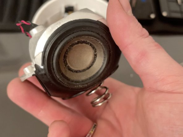

    13. Nest IQ Outdoor Camera Module Disassembly, Remove Speaker Module Screws: 手順 13、 3の画像 1 Nest IQ Outdoor Camera Module Disassembly, Remove Speaker Module Screws: 手順 13、 3の画像 2 Nest IQ Outdoor Camera Module Disassembly, Remove Speaker Module Screws: 手順 13、 3の画像 3
      • The spring that is under this module is quite powerful. While removing screws you must press down with significant force in order to remove the screws. If you do not hold down the module, it will be much more difficult to remove the screws.
      • Remove the three screws holding down the speaker module.
      • Screws Used
      • 3 x Torx T9 4.5(?)mm Screws
      FixBotに聞いてみる
      コメントを追加
    14. Nest IQ Outdoor Camera Module Disassembly, Remove Speaker Module: 手順 14、 3の画像 1 Nest IQ Outdoor Camera Module Disassembly, Remove Speaker Module: 手順 14、 3の画像 2 Nest IQ Outdoor Camera Module Disassembly, Remove Speaker Module: 手順 14、 3の画像 3
      • Lift the Speaker Module and Spring out of the case, threading the power cable down through the middle.
      • Because this was a dead unit being disassembled there is water damage on the bottom of this speaker module.

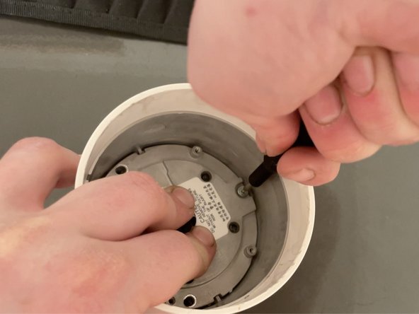

    15. Nest IQ Outdoor Camera Module Disassembly, Remove Power Board Screws: 手順 15、 3の画像 1 Nest IQ Outdoor Camera Module Disassembly, Remove Power Board Screws: 手順 15、 3の画像 2 Nest IQ Outdoor Camera Module Disassembly, Remove Power Board Screws: 手順 15、 3の画像 3
      • Bend/move the power cable to the side and remove each of the two screws holding down the Power Board.
      • Screws Used
      • 2 x Torx T5 3(?)mm screws
      • Performing Step 16 first can make this step easier.

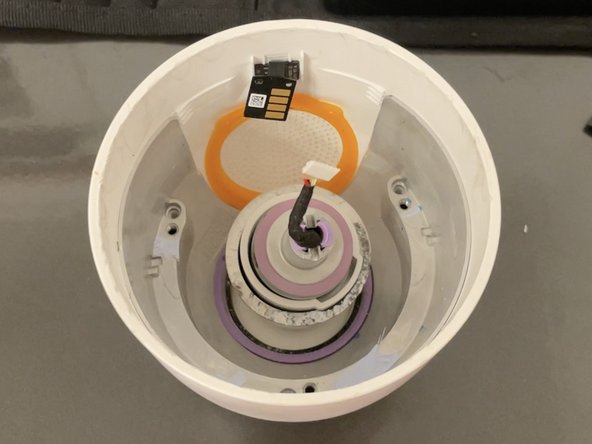

    18. Nest IQ Outdoor Camera Module Disassembly: 手順 18、 1の画像 1
      • Remove the final two screws to release the base ball joint from the inside of the housing.
