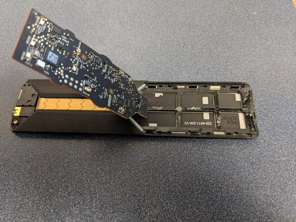

  4. NVIDIA (2015) Remote P2575 Battery Replacement and Breakdown, Removing the first Circuit Board: 手順 4、 3の画像 1 NVIDIA (2015) Remote P2575 Battery Replacement and Breakdown, Removing the first Circuit Board: 手順 4、 3の画像 2 NVIDIA (2015) Remote P2575 Battery Replacement and Breakdown, Removing the first Circuit Board: 手順 4、 3の画像 3
    • Use the Jimmy to prop the circuit board from the glue attached to the casing. Becareful of the ribbon attached. The circuit board will come out away from the ribbon if you remove it from the glue.
  5. NVIDIA (2015) Remote P2575 Battery Replacement and Breakdown, Removing the Ribbon Cable from Circuit: 手順 5、 2の画像 1 NVIDIA (2015) Remote P2575 Battery Replacement and Breakdown, Removing the Ribbon Cable from Circuit: 手順 5、 2の画像 2
    • Once you have the Circuit out of the glue you will see the shown Ribbon attachment clip moved up to be removed. Second picture the board is removed.

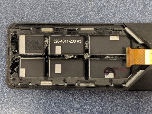

  6. NVIDIA (2015) Remote P2575 Battery Replacement and Breakdown, Removing the Ribbon Sensor and Battery Compartment: 手順 6、 3の画像 1 NVIDIA (2015) Remote P2575 Battery Replacement and Breakdown, Removing the Ribbon Sensor and Battery Compartment: 手順 6、 3の画像 2 NVIDIA (2015) Remote P2575 Battery Replacement and Breakdown, Removing the Ribbon Sensor and Battery Compartment: 手順 6、 3の画像 3
    この手順で使用する道具:
    • The Sensor Ribbon is carefully peeled away from the glue. There are two options available to get the battery compartment out. You can either use the Tweezers and push near the ribbon cable or you can use the tweezers to push from the other end inside and under the Sensor place as seen in the picture.
  7. NVIDIA (2015) Remote P2575 Battery Replacement and Breakdown, Removing the Battery from the housing: 手順 7、 3の画像 1 NVIDIA (2015) Remote P2575 Battery Replacement and Breakdown, Removing the Battery from the housing: 手順 7、 3の画像 2 NVIDIA (2015) Remote P2575 Battery Replacement and Breakdown, Removing the Battery from the housing: 手順 7、 3の画像 3
    • From here you can remove the Single Phillips Screw using the Phillips 00 Driver Bit. This will let you pry the circuit and battery from the Glue . You can lift the Battery from the Circuit board as it is made to lift upward and away from the board.
