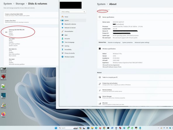

  9. Microsoft Surface Book 2 15" SSD Replacement: 手順 9、 2の画像 1 Microsoft Surface Book 2 15" SSD Replacement: 手順 9、 2の画像 2
    • After reassembly, I made a fresh install of Windows 11 Pro and now I have a computer ready for 3 to 5 more years, hopefully.
    • ADVICE 1: This tutorial is definitely not for the faint of heart! In the process of disconnecting the cables, one miscalculated movement and my screen got broken and I had to order a replacement from Aliexpress.
    • If you will order a display replacement, make sure to order one that has capacitive touch, not resistive one, otherwise you will only be able to use it with the Surface Pen.
    • ADVICE 2: As I knew I would need it too, I also purchased an additional set of taylor-made two-faced adhesive stripes to hold the screen back in place. Link is in the tool list
