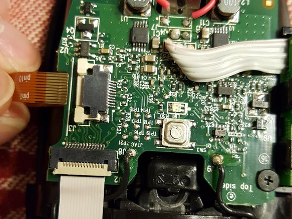

  6. Logitech Anywhere Mouse MX Full Disassembly, Ribbon cables: 手順 6、 3の画像 1 Logitech Anywhere Mouse MX Full Disassembly, Ribbon cables: 手順 6、 3の画像 2 Logitech Anywhere Mouse MX Full Disassembly, Ribbon cables: 手順 6、 3の画像 3
    • Disconnect the orange ribbon cable by carefully pulling the white locking bar horizontally out from the socket. The ribbon cable should then easily slip out of the unlocked socket.
  7. Logitech Anywhere Mouse MX Full Disassembly, Ribbon cables: 手順 7、 3の画像 1 Logitech Anywhere Mouse MX Full Disassembly, Ribbon cables: 手順 7、 3の画像 2 Logitech Anywhere Mouse MX Full Disassembly, Ribbon cables: 手順 7、 3の画像 3
    • Disconnect the white ribbon cable by flipping the white retention lever up. The ribbon cable should then easily slip out of the unlocked socket.

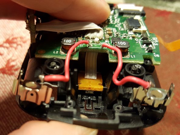

  10. Logitech Anywhere Mouse MX Full Disassembly, Rear battery contacts: 手順 10、 2の画像 1 Logitech Anywhere Mouse MX Full Disassembly, Rear battery contacts: 手順 10、 2の画像 2
    • Pull gently on the rear battery contacts to slide them out of their held location in the casing.

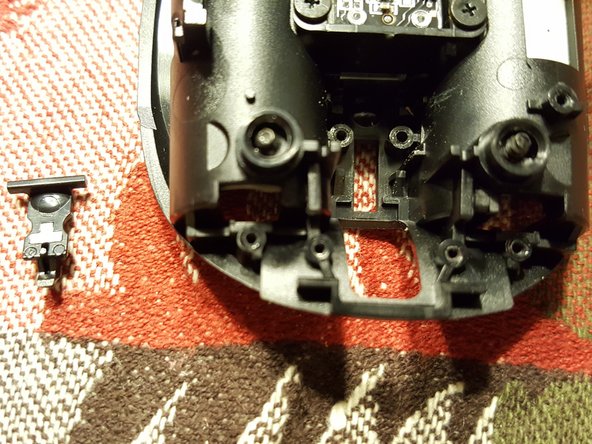

    • Once the power switch circuit board is unscrewed, a small plastic piece can then fall out of the casing. This piece serves to press down on the power switch when the lens cover of the mouse is closed.
  13. Logitech Anywhere Mouse MX Full Disassembly, Power switch board: 手順 13、 3の画像 1 Logitech Anywhere Mouse MX Full Disassembly, Power switch board: 手順 13、 3の画像 2 Logitech Anywhere Mouse MX Full Disassembly, Power switch board: 手順 13、 3の画像 3
    • If the plastic piece fell out, this is how it should be positioned when reassembling the mouse. The plastic piece is marked in blue.

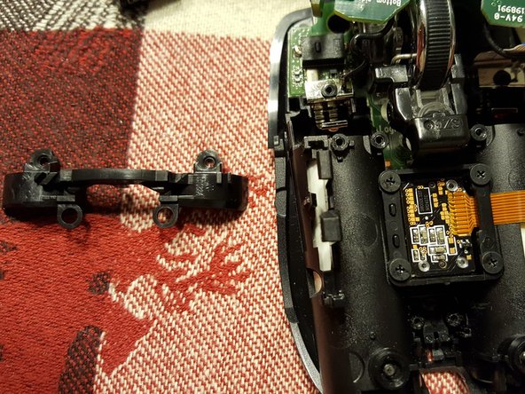

  14. Logitech Anywhere Mouse MX Full Disassembly, Removing the scroll wheel: 手順 14、 3の画像 1 Logitech Anywhere Mouse MX Full Disassembly, Removing the scroll wheel: 手順 14、 3の画像 2 Logitech Anywhere Mouse MX Full Disassembly, Removing the scroll wheel: 手順 14、 3の画像 3
    • With the power switch board unscrewed, you should now be able to flip the main board upwards.
    • Unscrew the two screws indicated in red.
    • The retaining bridge should now easily come off.

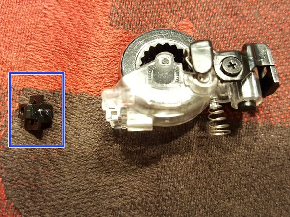

  15. Logitech Anywhere Mouse MX Full Disassembly, Removing the scroll wheel: 手順 15、 3の画像 1 Logitech Anywhere Mouse MX Full Disassembly, Removing the scroll wheel: 手順 15、 3の画像 2 Logitech Anywhere Mouse MX Full Disassembly, Removing the scroll wheel: 手順 15、 3の画像 3
    • Remove the screw circled in red.
    • The scroll wheel assembly can now be lifted upwards and removed from the mouse.

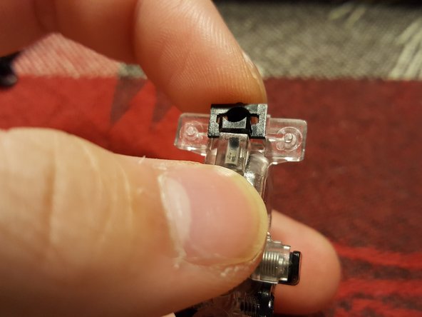

    • The black plastic piece where the screw removed in this step is located is spring loaded and can fall out of the scroll wheel assembly. Be sure not to lose this piece.

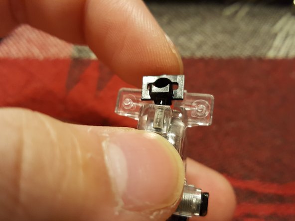

  16. Logitech Anywhere Mouse MX Full Disassembly, Removing the scroll wheel: 手順 16、 3の画像 1 Logitech Anywhere Mouse MX Full Disassembly, Removing the scroll wheel: 手順 16、 3の画像 2 Logitech Anywhere Mouse MX Full Disassembly, Removing the scroll wheel: 手順 16、 3の画像 3
    • If the black plastic piece has fallen out of the scroll wheel assembly, it should be oriented like this when reassembled.
    • The plastic piece has a small peg that inserts into a spring-loaded hole in the scroll wheel assembly.

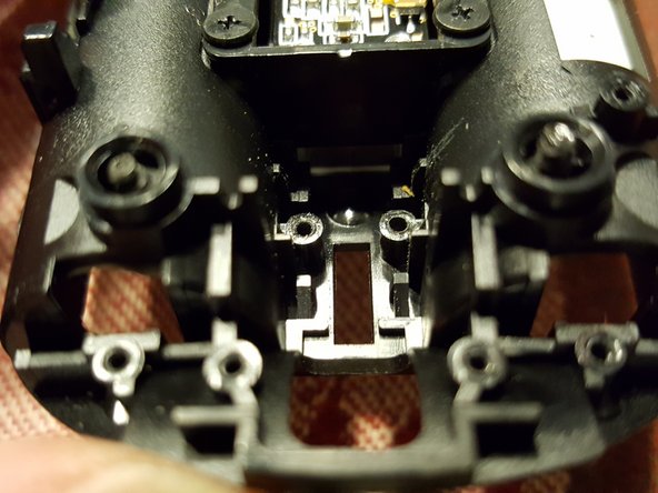

  17. Logitech Anywhere Mouse MX Full Disassembly, Left/right button board: 手順 17、 3の画像 1 Logitech Anywhere Mouse MX Full Disassembly, Left/right button board: 手順 17、 3の画像 2 Logitech Anywhere Mouse MX Full Disassembly, Left/right button board: 手順 17、 3の画像 3
    • Remove the screws from the three locations circled in red.
    • The left/right button board can now be easily removed from the mouse casing.
    • The two main microswitches are indicated in blue.

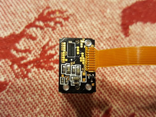

  18. Logitech Anywhere Mouse MX Full Disassembly, Darkfield sensor and lens: 手順 18、 3の画像 1 Logitech Anywhere Mouse MX Full Disassembly, Darkfield sensor and lens: 手順 18、 3の画像 2 Logitech Anywhere Mouse MX Full Disassembly, Darkfield sensor and lens: 手順 18、 3の画像 3
    • Remove the four screws circled in red. The sensor assembly can then be easily removed by pulling it up and out of the casing.
    • Now you can clean the lens of the mouse. The sensor itself is permanently attached to the lens however.
    • This particular sensor integrates the infrared laser diodes in the same package. It is rated at a sensitivity of 1000 DPI.
