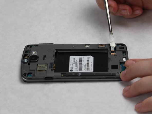

    • Insert the spudger into the small groove under one of the two black pieces.
  4. LG Rebel Screen Replacement: 手順 4、 2の画像 1 LG Rebel Screen Replacement: 手順 4、 2の画像 2
    • Using either your finger or the spudger, gently lift the metal clasps until they are no longer connected to the back of the phone.
