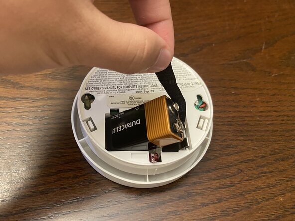

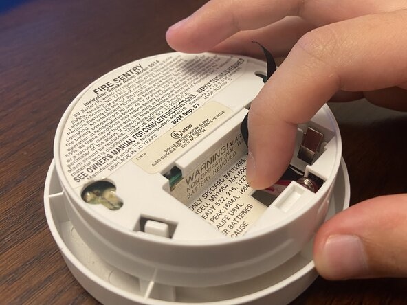

    • This device was missing the battery cover, but if your smoke detector has one, remove it from the bottom of the device.
    • Pull the black strap upwards to remove the old battery.
    • Dispose of the old battery properly.

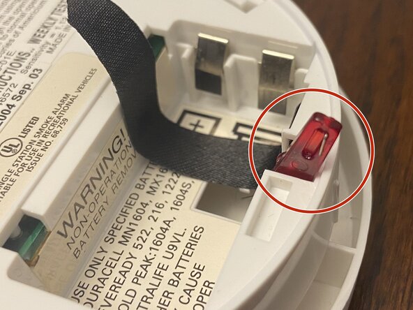

    • Push the red switch down with your finger.
  5. Kidde Fire Sentry Smoke Detector Battery Replacement: 手順 5、 1の画像 1

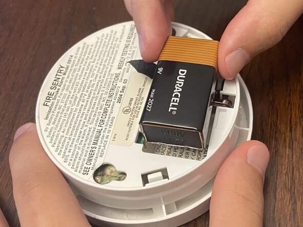

    • Place the new battery on top of the red switch and black strap.
    • Place the new battery in the battery compartment ensuring the red switch stays down.
    • Make sure the positive and negative sides of battery are oriented correctly.

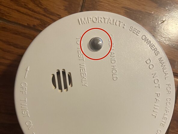

  6. Kidde Fire Sentry Smoke Detector Battery Replacement: 手順 6、 2の画像 1 Kidde Fire Sentry Smoke Detector Battery Replacement: 手順 6、 2の画像 2

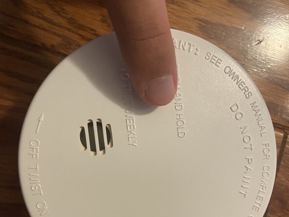

    • Press and hold button on the front for three seconds and wait for a beep.
    • After hearing a beep, stop pressing button.

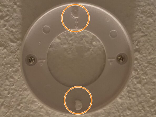

    • Find the grooves located on the back of the smoke detector.
    • Match them with the tabs hanging from the ceiling piece.
    • Twist the smoke detector counter-clockwise to secure it to the ceiling.
