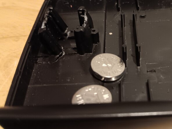

  3. KK-82MS-B Battery Replacement, Remove and replace the battery.: 手順 3、 2の画像 1 KK-82MS-B Battery Replacement, Remove and replace the battery.: 手順 3、 2の画像 2
    • Unfortunately, you cannot remove the battery without some sort of damage. The easiest way to do this is to break the top so the walls are still there to keep the battery in place.
    • This is very dangerous, there is a high chance of puncturing the battery.
    • Insert your new batteries into the same spot as the previous ones.
    • Slide the blue wires back into place.
