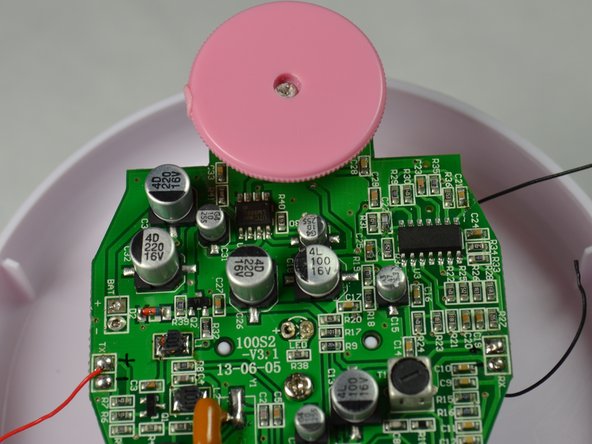

  6. Jumper Angelsounds JPD-100S Volume Knob Replacement: 手順 6、 1の画像 1
    • With your hand, remove the pink component.
  7. Jumper Angelsounds JPD-100S Volume Knob Replacement: 手順 7、 1の画像 1
    • Remove the 7mm Phillips #1 screw in the middle of the motherboard.
  8. Jumper Angelsounds JPD-100S Volume Knob Replacement, Volume Knob: 手順 8、 2の画像 1 Jumper Angelsounds JPD-100S Volume Knob Replacement, Volume Knob: 手順 8、 2の画像 2
    この手順で使用する道具:
    • Remove the white glue on the volume knob by peeling it off or gently using tweezers to pull it out.
    • Allow approximately 10 minutes for the soldering station to heat up before using.
  9. Jumper Angelsounds JPD-100S Volume Knob Replacement: 手順 9、 2の画像 1 Jumper Angelsounds JPD-100S Volume Knob Replacement: 手順 9、 2の画像 2
    • Remove the 5mm Phillips #00 screw holding the volume knob to the motherboard.
    • Place the screw and volume knob in a secure, safe place.
  10. Jumper Angelsounds JPD-100S Volume Knob Replacement: 手順 10、 3の画像 1 Jumper Angelsounds JPD-100S Volume Knob Replacement: 手順 10、 3の画像 2 Jumper Angelsounds JPD-100S Volume Knob Replacement: 手順 10、 3の画像 3
    • Unsolder the five points holding the volume knob to the motherboard.
    • Carefully place the soldering iron down, as you will need it for reassembly.
