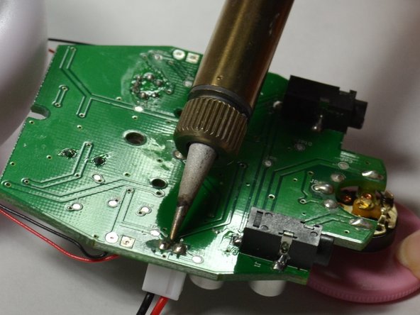

  8. Jumper Angelsounds JPD-100S Battery Cable Replacement, Battery Cable: 手順 8、 2の画像 1 Jumper Angelsounds JPD-100S Battery Cable Replacement, Battery Cable: 手順 8、 2の画像 2
    • Preheat soldering iron.
    • Locate the battery cable leads on the motherboard.
  9. Jumper Angelsounds JPD-100S Battery Cable Replacement: 手順 9、 2の画像 1 Jumper Angelsounds JPD-100S Battery Cable Replacement: 手順 9、 2の画像 2
    • Use a soldering iron and solder vacuum to unsolder the battery cable leads.
  10. Jumper Angelsounds JPD-100S Battery Cable Replacement: 手順 10、 1の画像 1
    • Remove the battery cables by pulling them out of the motherboard.
