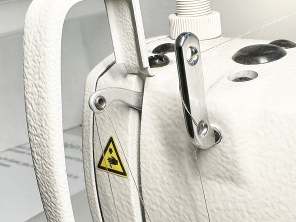

    • Turn the hand-wheel counter-clockwise (following the arrow) so that the needle position is at its highest point.
    • Make sure sewing machine is turned off and disconnected from power.

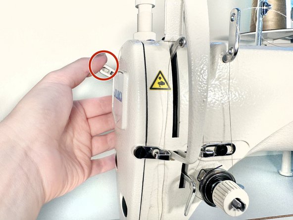

    • On the left side of the machine there is a presser foot lifter. Push it down to lower the foot.
    • The foot will be flush with the machine.

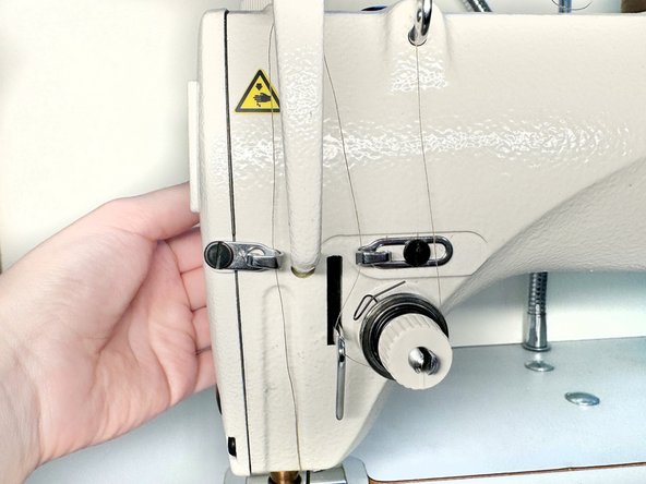

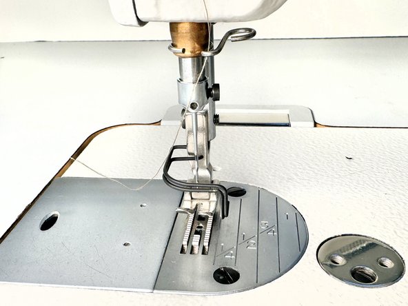

    • Remove the thread from the needle by pulling the thread towards you and out of the hole.

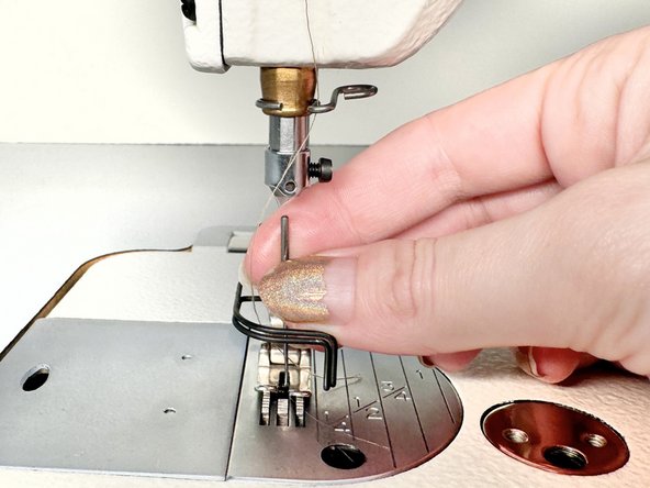

    • Loosen the needle clamp screw on the right side of the machine by turning the screwdriver in a counter-clockwise motion.
  5. Juki DDL-8700 Needle Replacement: 手順 5、 2の画像 1 Juki DDL-8700 Needle Replacement: 手順 5、 2の画像 2
    • Remove the broken needle by firmly pulling it straight down.
    • Handle needle with causion to prevent injury.

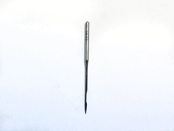

    • Select the correct needle for a Juki DDL-8700, depending on your project.
    • Note the notch on the end of the needle.
    • The standard needle is 16 x 257.

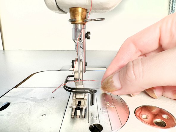

  8. Juki DDL-8700 Needle Replacement: 手順 8、 2の画像 1 Juki DDL-8700 Needle Replacement: 手順 8、 2の画像 2

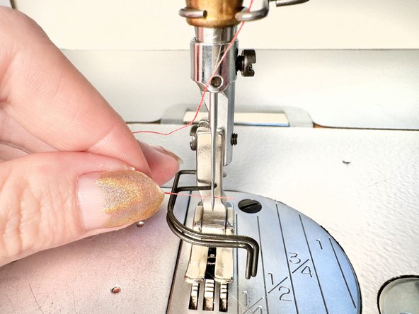

    • Rethread the needle by passing the thread through the hole from left to right.
