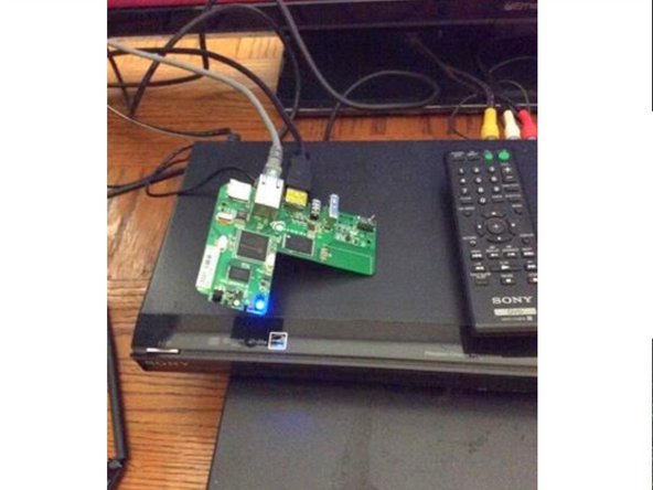

  3. Jadoo 3 Power Port Replacement: 手順 3、 1の画像 1
    • Black wire will be connected to the first point on the right side and Red wire will be the first point on left side of the board. If in case doesn’t work the change the step to the opposite.If board lights on its mean wire should be solder with the board.
  4. Jadoo 3 Power Port Replacement: 手順 4、 2の画像 1 Jadoo 3 Power Port Replacement: 手順 4、 2の画像 2
    • For the safety of wire melt the glue stick on wire with board to safe from moving
