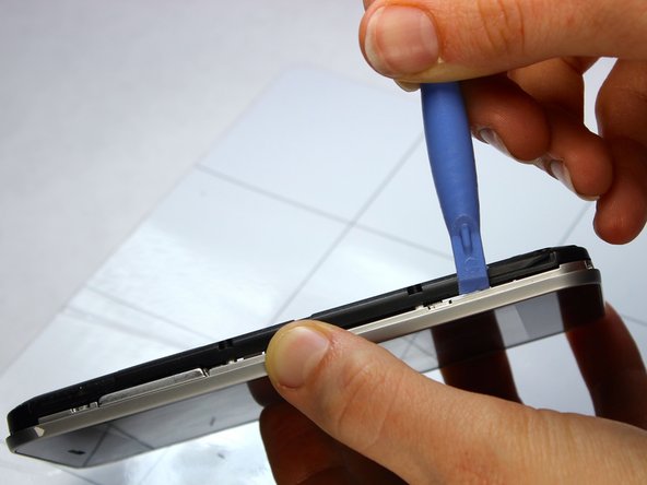

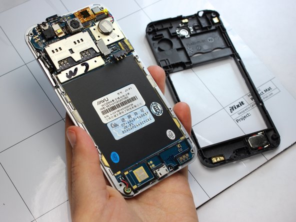

  4. JIAYU F1 Camera Lens Replacement, Remove the Interior Midframe Assembly: 手順 4、 3の画像 1 JIAYU F1 Camera Lens Replacement, Remove the Interior Midframe Assembly: 手順 4、 3の画像 2 JIAYU F1 Camera Lens Replacement, Remove the Interior Midframe Assembly: 手順 4、 3の画像 3
    • With the phone lying face down, remove the nine 3 mm Phillips # 00 screws from the midframe.
    • Gently run a plastic opening tool down along the left and right sides of the phone to separate the black midframe assembly from the silver display casing.
    • Carefully remove the midframe assembly from the display casing by pulling up and away from the phone.

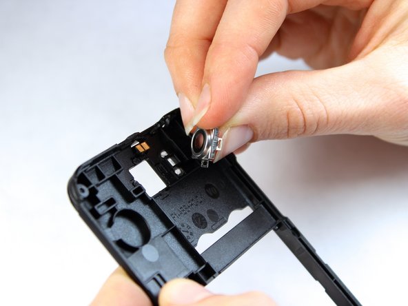

  5. JIAYU F1 Camera Lens Replacement, Remove the Camera Lens: 手順 5、 3の画像 1 JIAYU F1 Camera Lens Replacement, Remove the Camera Lens: 手順 5、 3の画像 2 JIAYU F1 Camera Lens Replacement, Remove the Camera Lens: 手順 5、 3の画像 3
    • Holding the midframe face-up, locate the camera lens near the top center of the midframe.
    • Use your finger to gently apply pressure against the lens until it pops out of the back of the midframe.

    • Turn the frame over so that it is face-down.
    • Using the precision tweezers, place the new camera lens into the lens cavity and align the clasps against the groves in the midframe.
    • Using your finger, apply pressure on the lens until the clasps pop onto the grooves.
