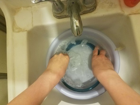

  3. Hydration Pack Bladder Hose Bite Valve Replacement: 手順 3、 3の画像 1 Hydration Pack Bladder Hose Bite Valve Replacement: 手順 3、 3の画像 2 Hydration Pack Bladder Hose Bite Valve Replacement: 手順 3、 3の画像 3
    • Use mild soap and water to clean the outside of the tube. Swirl the water with your hands to mix the soap and water well.
    • The method I used was to soak it in a bowl of hot soapy water for 5 - 10 minutes before rinsing it, which will clean the outside and inside of the tube. This will let you skip the next step. However, this requires a big enough bowl to fit the hose.

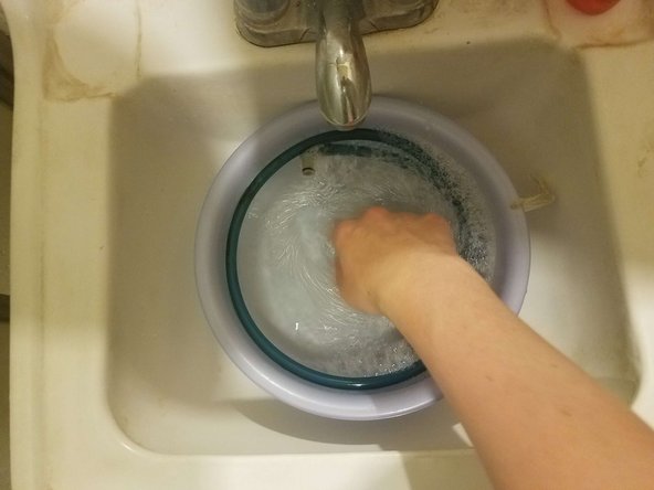

  5. Hydration Pack Bladder Hose Bite Valve Replacement: 手順 5、 3の画像 1 Hydration Pack Bladder Hose Bite Valve Replacement: 手順 5、 3の画像 2 Hydration Pack Bladder Hose Bite Valve Replacement: 手順 5、 3の画像 3
    • Clean and dry the new bite valve, inside and out. I reused the hot soapy water bowl from Step 3 to do it. Rinse it after. Make sure everything is dry before moving onto the next step.
    • Depending on how new that mouth piece is, you might need to clean it. As you see here, I used the soapy water bowl to do that.

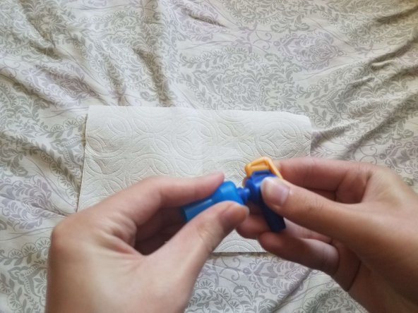

  6. Hydration Pack Bladder Hose Bite Valve Replacement: 手順 6、 3の画像 1 Hydration Pack Bladder Hose Bite Valve Replacement: 手順 6、 3の画像 2 Hydration Pack Bladder Hose Bite Valve Replacement: 手順 6、 3の画像 3
    • Attach the new mouth piece to the new bite valve.
    • Mines had a little hole you have to open up while pushing the bite valve through it.

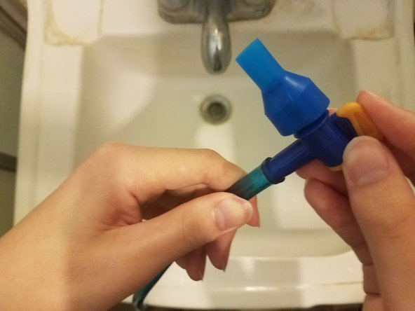

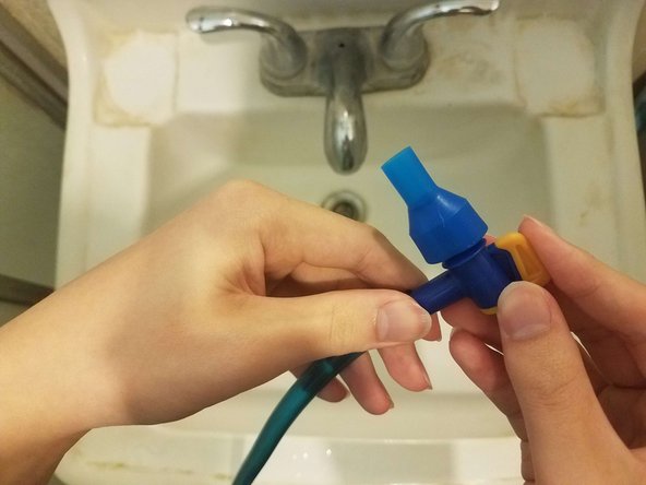

  7. Hydration Pack Bladder Hose Bite Valve Replacement: 手順 7、 3の画像 1 Hydration Pack Bladder Hose Bite Valve Replacement: 手順 7、 3の画像 2 Hydration Pack Bladder Hose Bite Valve Replacement: 手順 7、 3の画像 3
    • Attach the new bite valve to the hose.
    • If you’re having trouble attaching it, you can use a lighter to heat the tube and make it pliable. Watch carefully and don’t melt it. I did this step at the sink just in case I needed water for an accident.
