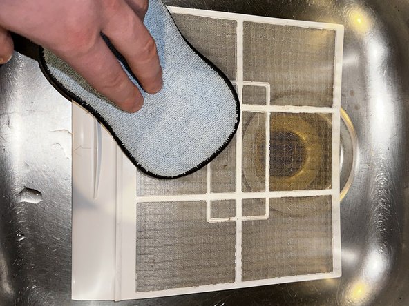

  3. How to repair AC leaks: 手順 3、 2の画像 1 How to repair AC leaks: 手順 3、 2の画像 2
    • Check the filter for ice and dirt, wash the filter thoroughly as most AC filters are washable. If there is excess ice and dirt, replacing the filter is advised.
