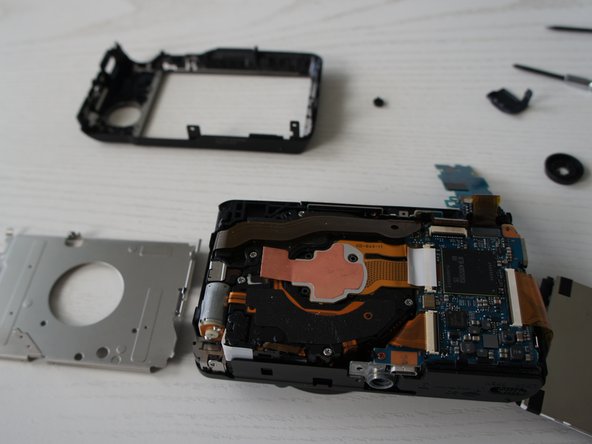

How to clean lens
必要な工具と部品
  1. How to clean lens, Remove battery.: 手順 1、 1の画像 1
    • Insert wisdom here.
  2. How to clean lens, Remove cover on end of camera.: 手順 2、 1の画像 1
    • Remove black screw on bottom corner near bottom left of picture viewing screen. Gently pry off end of camera, exposing 2 black screws. Remove both screws.
    • If present, remove hand strap.
    • On hand strap anchor end, remove two black screws.
    • There are two black screws on the bottom of the camera right by the tripod mount. Remove the screw nearest to the back of the camera.
    • Open HDMI cover and remove single black screw.
  3. How to clean lens: 手順 6、 1の画像 1
    • Gently pry off back of camera.
  4. How to clean lens: 手順 7、 1の画像 1
    • Remove dial and centre button.
  5. How to clean lens: 手順 8、 1の画像 1
    • Remove small circuit board.
  6. How to clean lens: 手順 9、 1の画像 1
    • Remove black screw in upper corner, and black screw from top.
    • Remove metal cover.
  7. How to clean lens: 手順 10、 1の画像 1
    • Remove three silver screws.
    • Gently lift copper tab to expose lens and CCD.
    • Swab lens with 99% isopropyl rubbing alcohol (99% leaves very little residue when dry.)
