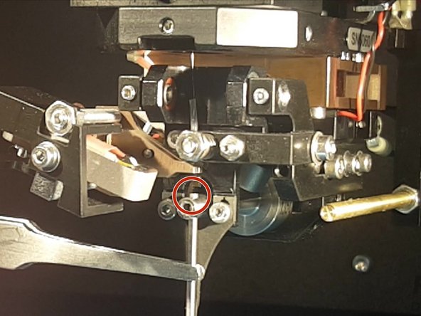

  2. How to change Tool for DeepAccess, Remove wedge from transducer: 手順 2、 3の画像 1 How to change Tool for DeepAccess, Remove wedge from transducer: 手順 2、 3の画像 2 How to change Tool for DeepAccess, Remove wedge from transducer: 手順 2、 3の画像 3
    この手順で使用する道具:
    • Grab wegdge with tweezers
    • Loosen the screw. (while holding the wedge)
    • Get rid of the copper screw. To NOT use it more than once

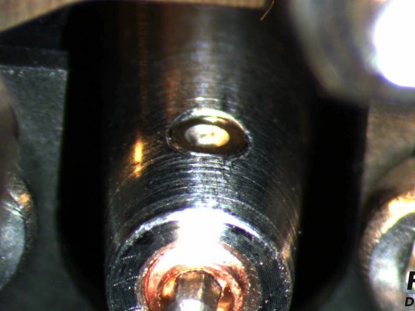

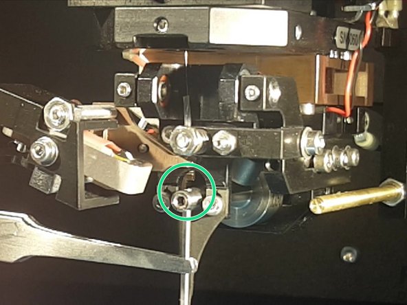

  3. How to change Tool for DeepAccess, Place the new wedge in the transducer.: 手順 3、 3の画像 1 How to change Tool for DeepAccess, Place the new wedge in the transducer.: 手順 3、 3の画像 2 How to change Tool for DeepAccess, Place the new wedge in the transducer.: 手順 3、 3の画像 3
    • Put the wedge in the tranducer from below.
    • Take care, that the Tool Top is flush with the Transducer surface
    • Correct Placement. Tool is flush with transducer.
    • Incorrect Placement. tool is too high.
  4. How to change Tool for DeepAccess, Fasten the copper screw: 手順 4、 2の画像 1 How to change Tool for DeepAccess, Fasten the copper screw: 手順 4、 2の画像 2
    • Fasten the screw lightly
    • Tighten the screw just so the wedge does not slip out of the tranducer.
    • in case of appliying too much torque. Use a new screw and get rid of the old one.

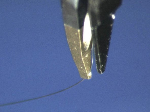

    • Use tweezers to push the wire down the wire hole, until it Ends some cm below the tool wedge.
    • Use scissors to cut the (contaminated) Wire down to a length of about 1cm below wedge end.

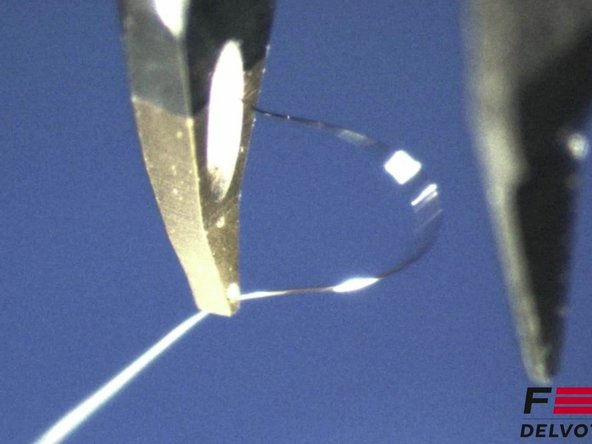

  6. How to change Tool for DeepAccess, Thread Wire through Wedge-hole: 手順 7、 3の画像 1 How to change Tool for DeepAccess, Thread Wire through Wedge-hole: 手順 7、 3の画像 2 How to change Tool for DeepAccess, Thread Wire through Wedge-hole: 手順 7、 3の画像 3
    • Use tweezers to thread the wire through the hole at the end of the wedge.
    • Afet threading pull the wire some cm through the hole.
