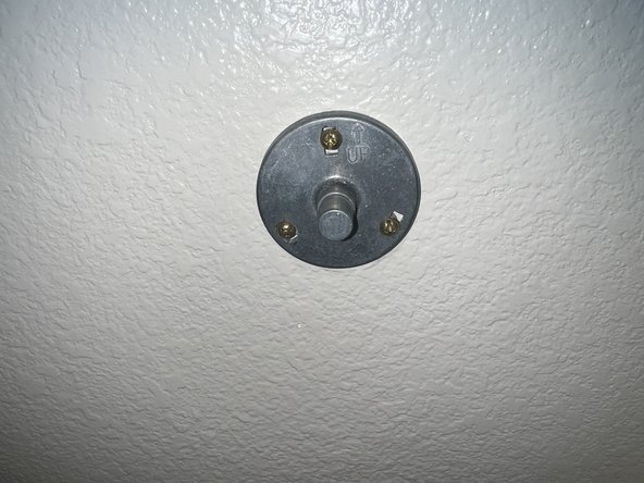

  4. How to Securely Anchor and Install a Towel Rack: 手順 4、 2の画像 1 How to Securely Anchor and Install a Towel Rack: 手順 4、 2の画像 2
    • Place the mounting bracket onto the wall making sure that the hole with "UP" next to it is aligned with the top hole. Screw in a screw through the mounting bracket into the drywall anchors.
