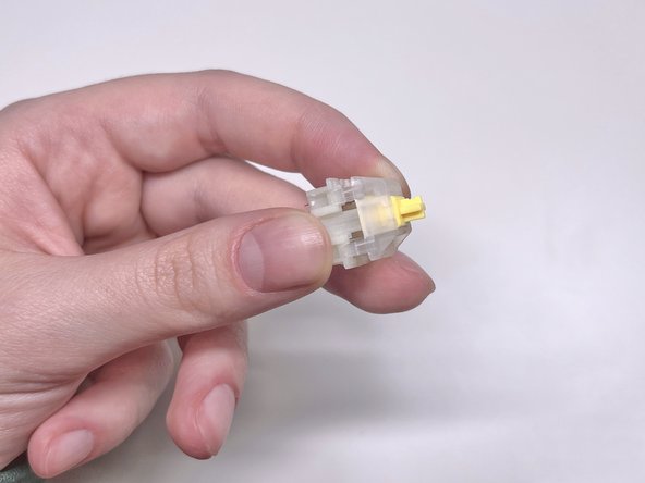

  3. How to Replace a Mechanical Switch Leaf on Gateron Switches: 手順 3、 1の画像 1
    • Use a switch puller to grip the top and bottom of the base of the switch.
    • Gently pull the switch straight upwards from the hot swappable socket on the keyboard.
    • This can only be done on a hot swappable keyboard. Other keyboards would require the switch to be desoldered from the PCB.

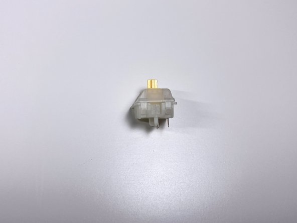

  4. How to Replace a Mechanical Switch Leaf on Gateron Switches: 手順 4、 2の画像 1 How to Replace a Mechanical Switch Leaf on Gateron Switches: 手順 4、 2の画像 2
    この手順で使用する道具:
    • To open the switch housing, align the prongs on the switch opener with the clasps holding the top and bottom of the switch.
    • Apply gentle pressure on the top of the switch until the upper switch housing detaches from the lower switch housing.
    • Remove the stem, upper housing, and spring, so that you are left with the lower housing and switch leaves.
    • You can use tweezers to pry off the clasps on each side of the switch if a switch opener is not available to you. Make sure you do not break or bend any clasps, and work with caution as tweezers can slip out of place easily.

  6. How to Replace a Mechanical Switch Leaf on Gateron Switches: 手順 6、 1の画像 1
    • Insert the new switch leaf by inserting the pin through the small hole at the bottom of the switch housing.
    • You know the leaf is fully inserted when the pin from the leaf is the same length as the other pin sticking out of the bottom of the housing.
