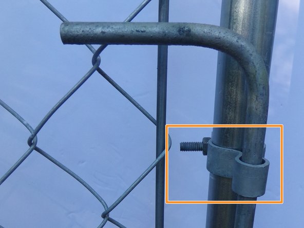

    • Remove the bolt from the hinge strap on the fence post.
    • Wipe the excess lubricant from the bolt to avoid slipping.
    • Slide the loosened hinge strap up to remove the pin from the loop on the gate hinge.
    • Use a 9/16" socket wrench or a crescent wrench.
    • Repeat this process for the bottom hinge.

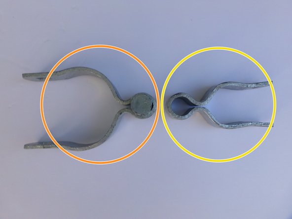

    • Open the Galvanized Drive Gate Set and verify that you have four hinge pairs.
    • Separate one of the hinge pairs.
    • The Post Hinge has a pin. The Gate Hinge has a loop.

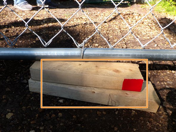

    • Place blocks on the ground at the where you will install the gate. These will support the gate while you are connecting the hinges.
    • Lift the gate panel into position so that the gate lines up with the fence and at the desired height. Adjust the blocks as necessary to achieve the desired height.
