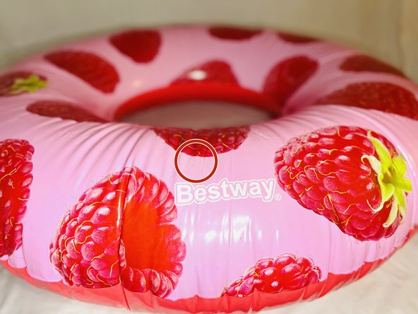

    • If the punctured area is not obvious:
    • Spritz soapy water over different areas of the inflated floatie and press down on the floatie until you see air bubbles.

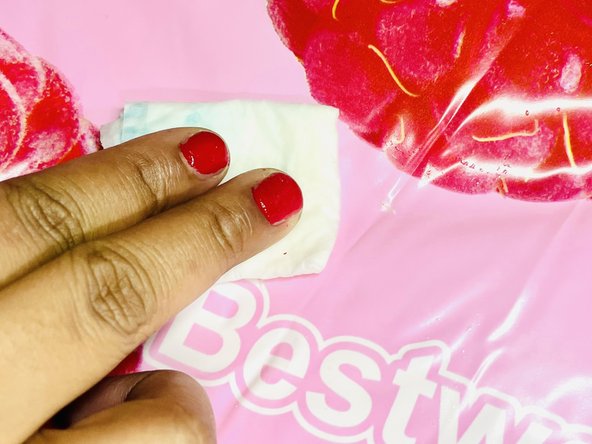

    • Clean the punctured area with alcohol wipes in order to help the waterproof tape adhere better.
    • Wait for the alcohol to completely dry.
    • If you do not have alcohol wipes available feel free to use soap, water and a towel. Then let the area dry completely.

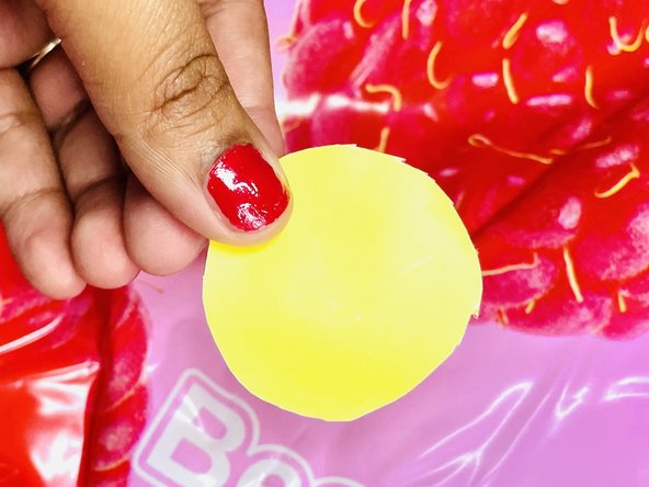

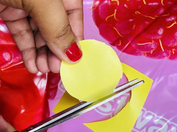

    • Cut the waterproof tape two centimeters wider than the punctured area.
    • You can cut the waterproof tape in a circle or square; whichever you prefer.

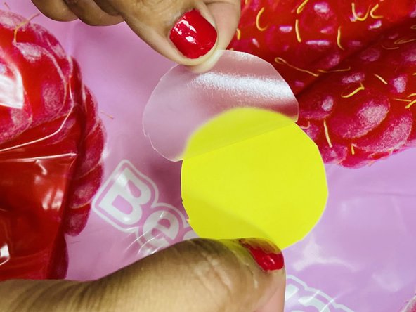

    • Peel off the backing of the waterproof tape and center it over the punctured area.
    • Make sure the area is flat that way the waterproof tape will have less air bubbles when applied.

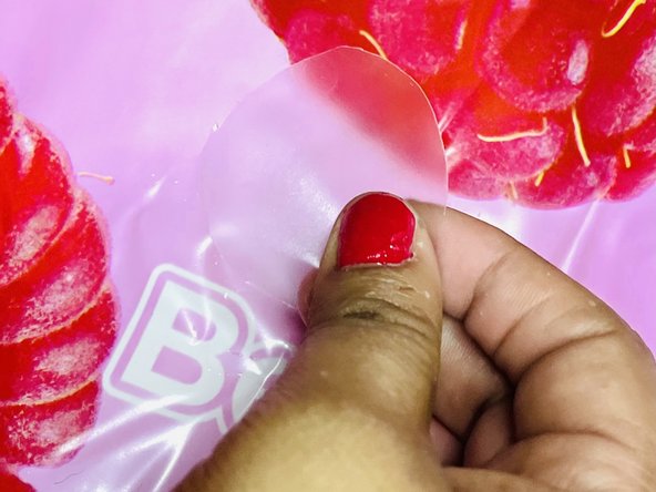

  6. How to Repair a Hole in an Inflatable Floatie: 手順 6、 2の画像 1 How to Repair a Hole in an Inflatable Floatie: 手順 6、 2の画像 2
    • Press down firmly on the patch making sure no air bubbles are visible.
    • Leave it for about 30 minutes.
    • Inflate your floatie and enjoy the water!
