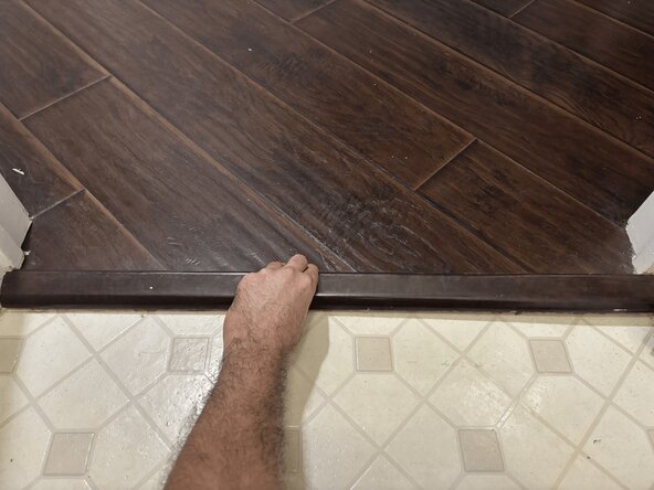

  1. How to Fix a Loose Wooden Door Threshold, How to Fix a Loose Wooden Door Threshold: 手順 1、 3の画像 1 How to Fix a Loose Wooden Door Threshold, How to Fix a Loose Wooden Door Threshold: 手順 1、 3の画像 2 How to Fix a Loose Wooden Door Threshold, How to Fix a Loose Wooden Door Threshold: 手順 1、 3の画像 3

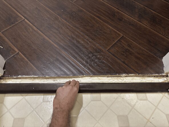

    • Use your hands to remove the door threshold.
    • Start lifting it from one of the two ends.

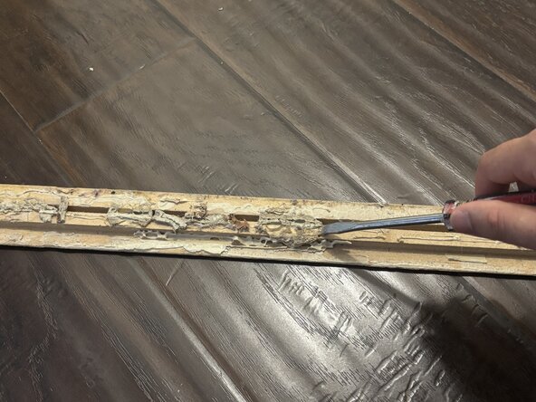

    • Use a paint scraper to remove the old wood glue and dirt that remains under the threshold.

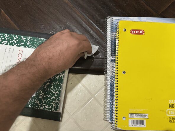

    • Use a cloth to clean the area once you're done scraping off any leftover glue residue.

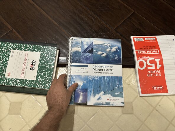

    • Before applying the glue, make sure you have some decently heavy objects, like books, that you can use for Step 5.
    • Make sure you have enough wood glue to cover the entire mounting surface from end to end.

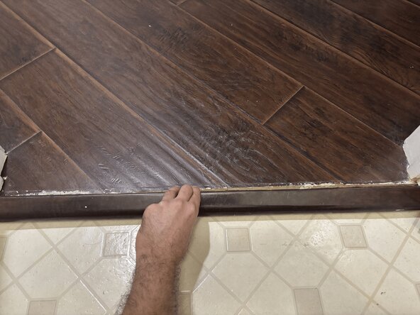

    • Place the threshold back in its original position.
    • Press down along the threshold for a few minutes to ensure it is secure.

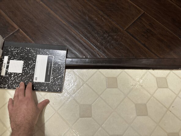

    • Place heavy books across the length of the threshold to keep the downward pressure while the wood glue dries.
    • Keep the heavy objects on the threshold for at least 6 hours to allow it to dry completely.
