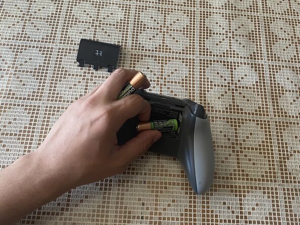

  1. How to Fix Xbox One Wireless Controller Drift, How to Fix Xbox One Wireless Controller Drift: 手順 1、 1の画像 1
    • Remove the batteries from the controller.
    • If you are using a wired controller, disconnect the wire.

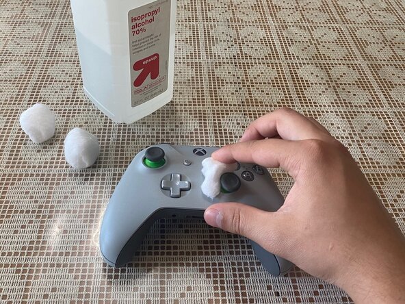

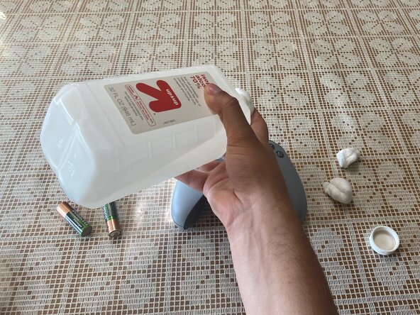

  2. How to Fix Xbox One Wireless Controller Drift: 手順 2、 3の画像 1 How to Fix Xbox One Wireless Controller Drift: 手順 2、 3の画像 2 How to Fix Xbox One Wireless Controller Drift: 手順 2、 3の画像 3
    • Pour 90% isopropyl alcohol on the tip of a cotton ball.
    • Keep the item away from children and avoid touching your face and open wounds while using it.

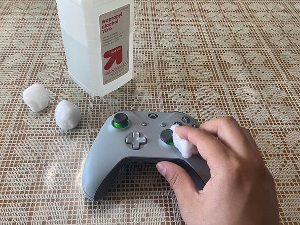

  3. How to Fix Xbox One Wireless Controller Drift: 手順 3、 2の画像 1 How to Fix Xbox One Wireless Controller Drift: 手順 3、 2の画像 2
    • Rub the cotton ball all along the edges of the thumbstick.

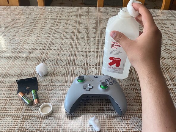

  4. How to Fix Xbox One Wireless Controller Drift: 手順 4、 1の画像 1
    • Let the controller dry for 40-60 seconds.
    • Repeat Steps 2-4 two more times or until the thumbstick no longer drifts.
  5. How to Fix Xbox One Wireless Controller Drift: 手順 5、 3の画像 1 How to Fix Xbox One Wireless Controller Drift: 手順 5、 3の画像 2 How to Fix Xbox One Wireless Controller Drift: 手順 5、 3の画像 3
    • Connect your controller and see if there are any drift stick problems in any game. If the issue continues, then the next best option is to replace the joystick, and if that doesn't work, it's time to buy a new controller.
