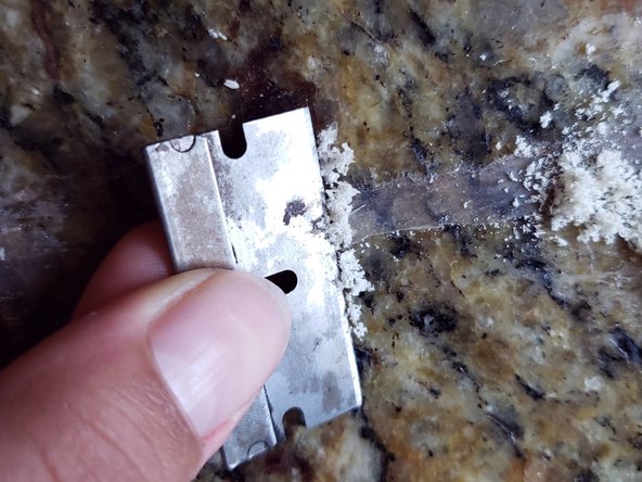

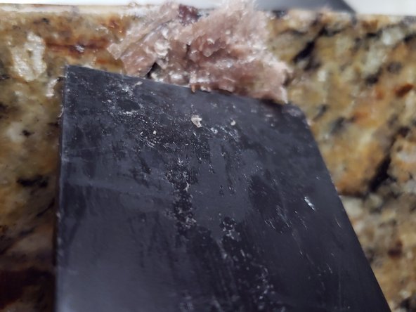

  6. How to Fast Fix a Crack on Granite Countertop: 手順 6、 3の画像 1 How to Fast Fix a Crack on Granite Countertop: 手順 6、 3の画像 2 How to Fast Fix a Crack on Granite Countertop: 手順 6、 3の画像 3
    • Use a putty knife or a razor to scrape off excess epoxy.
    • For a visibly flat finish, it's best to use a razor to scrape off the dry epoxy.

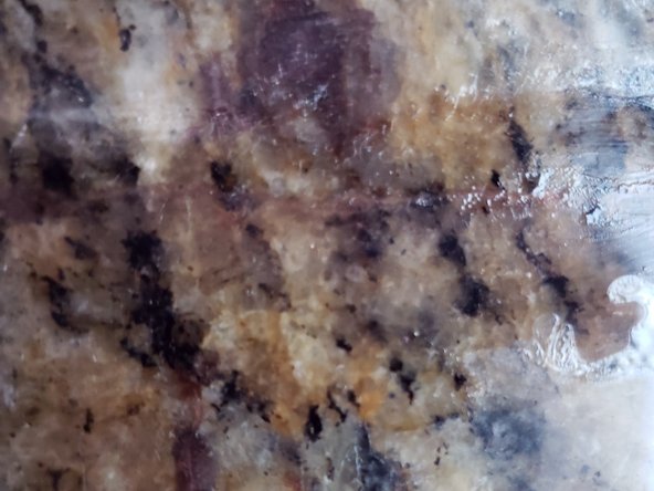

  7. How to Fast Fix a Crack on Granite Countertop: 手順 7、 2の画像 1 How to Fast Fix a Crack on Granite Countertop: 手順 7、 2の画像 2
    • Depending on the product used, The finished surface may look glossy.
    • Apply a granite sealer over the area.
