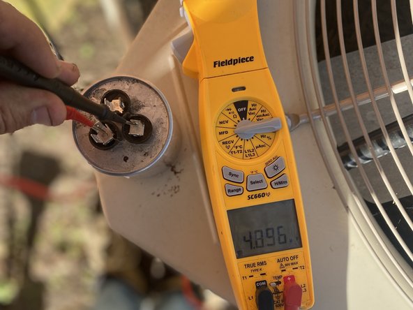

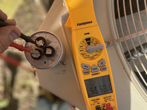

  6. HVAC Run Capacitor Replacement: 手順 6、 3の画像 1 HVAC Run Capacitor Replacement: 手順 6、 3の画像 2 HVAC Run Capacitor Replacement: 手順 6、 3の画像 3
    • Use your capacitance meter to read the microfarads between the 3-prong terminal (Hum) and the 4-prong terminal (common).
    • Repeat the process between the 1-prong (fan) and the 4-prong terminal (common).
  7. HVAC Run Capacitor Replacement: 手順 7、 1の画像 1
    • Compare the gathered readings with those printed on the capacitor label. If the numbers that you collected are roughly the same (within 0.4 microfarads) then the capacitor doesn't need to be replaced. If the difference is larger than 0.4 microfarads, then it's time to replace the capacitor.
