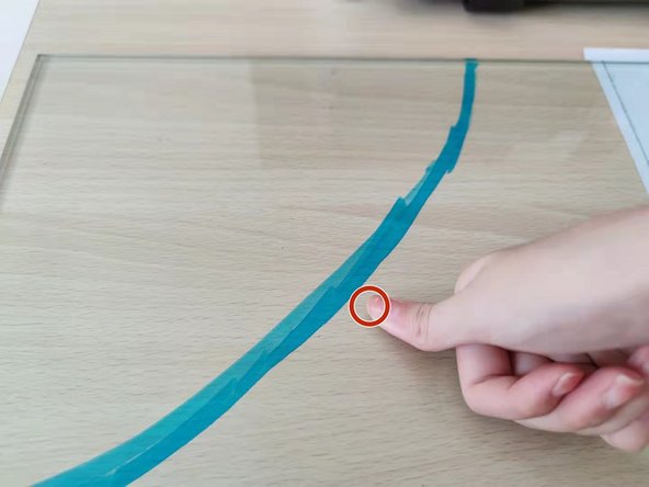

  3. Glass Shelving Replacement: 手順 3、 3の画像 1 Glass Shelving Replacement: 手順 3、 3の画像 2 Glass Shelving Replacement: 手順 3、 3の画像 3
    • Mark and measure the area to be cut.
    • Decide the size of the cut according to the size of the old glass panel.
    • It is recommended to use colored pens or markers to mark the glass directly for the next step of cutting.

  5. Glass Shelving Replacement: 手順 5、 3の画像 1 Glass Shelving Replacement: 手順 5、 3の画像 2 Glass Shelving Replacement: 手順 5、 3の画像 3
    • Split the glass plate.
    • Grasp the ends of the glass near the dividing line with your hands. Using your wrist, apply gentle pressure along the scratch line to split the glass in half. With just your wrist pressing on the glass, the elbow joint does not need to move.
    • If the glass panel is curved in shape, you need to lightly bounce the glass and then apply gentle pressure from the back of the glass against the middle point of the scratch line.
