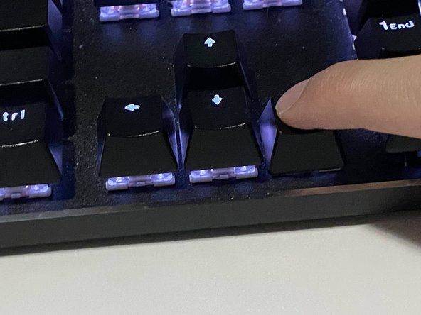

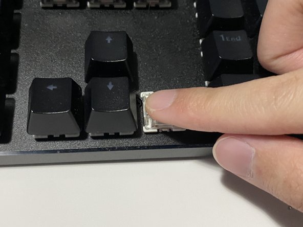

  3. GMMK-BRN Keyboard Switch Replacement: 手順 3、 2の画像 1 GMMK-BRN Keyboard Switch Replacement: 手順 3、 2の画像 2
    • Use the switch remover to push the tabs in on the opposite sides of the switch.
    • Firmly pull the switch upwards.
    • If the switch is pulled at an angle, there is a risk to damaging the switch.
    • The switch may not come out easily, so more force may be required.

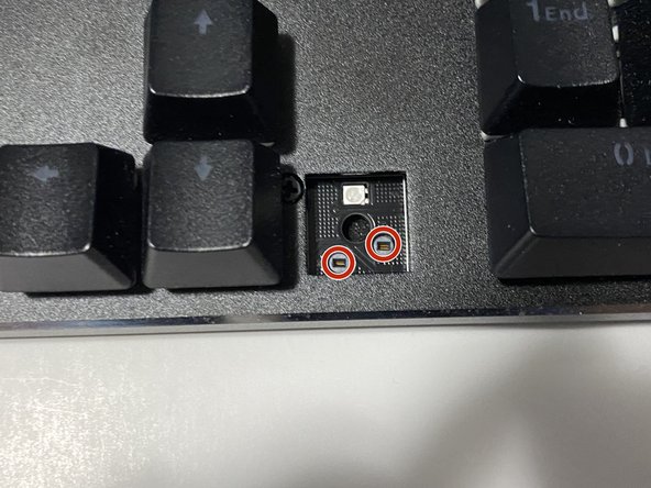

  4. GMMK-BRN Keyboard Switch Replacement: 手順 4、 3の画像 1 GMMK-BRN Keyboard Switch Replacement: 手順 4、 3の画像 2 GMMK-BRN Keyboard Switch Replacement: 手順 4、 3の画像 3
    • Align the pins on the keycap with the ones inside the keyboard.
    • Insert the switch, and press down firmly until a click is heard.

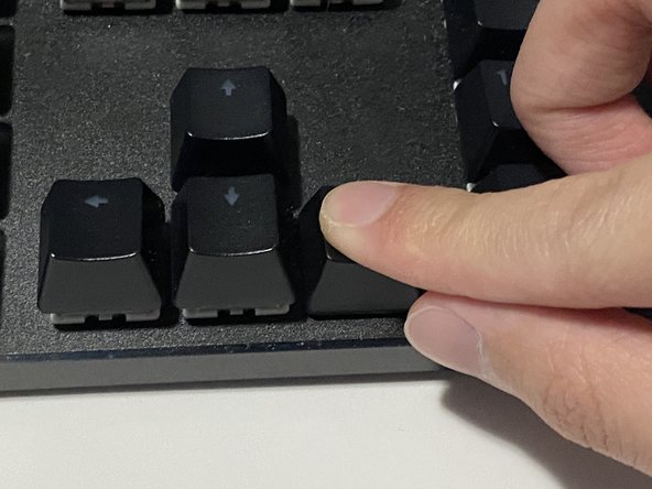

  5. GMMK-BRN Keyboard Switch Replacement: 手順 5、 3の画像 1 GMMK-BRN Keyboard Switch Replacement: 手順 5、 3の画像 2 GMMK-BRN Keyboard Switch Replacement: 手順 5、 3の画像 3
    • Align the cross of the keycap with the cross of the switch.
    • Push the keycap down firmly to reattach.
