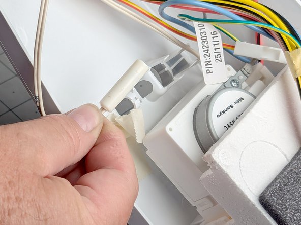

  7. Frigidaire Side-By-Side Refrigerator Freezer Thermistor Replacement, Locate fresh food thermistor: 手順 7、 2の画像 1 Frigidaire Side-By-Side Refrigerator Freezer Thermistor Replacement, Locate fresh food thermistor: 手順 7、 2の画像 2
    • Locate the fresh food thermistor and peel the tape to release the wiring.
  8. Frigidaire Side-By-Side Refrigerator Freezer Thermistor Replacement, Free the fresh food thermistor: 手順 8、 3の画像 1 Frigidaire Side-By-Side Refrigerator Freezer Thermistor Replacement, Free the fresh food thermistor: 手順 8、 3の画像 2 Frigidaire Side-By-Side Refrigerator Freezer Thermistor Replacement, Free the fresh food thermistor: 手順 8、 3の画像 3
    • Use your fingers to free the thermistor by pulling it out of the bracket securing it to the control housing.

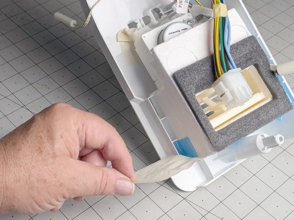

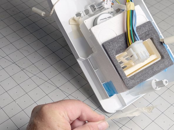

  9. Frigidaire Side-By-Side Refrigerator Freezer Thermistor Replacement, Unfasten the damper assembly: 手順 9、 3の画像 1 Frigidaire Side-By-Side Refrigerator Freezer Thermistor Replacement, Unfasten the damper assembly: 手順 9、 3の画像 2 Frigidaire Side-By-Side Refrigerator Freezer Thermistor Replacement, Unfasten the damper assembly: 手順 9、 3の画像 3
    • With your fingers, remove the tan tape securing the damper assembly to the control housing.

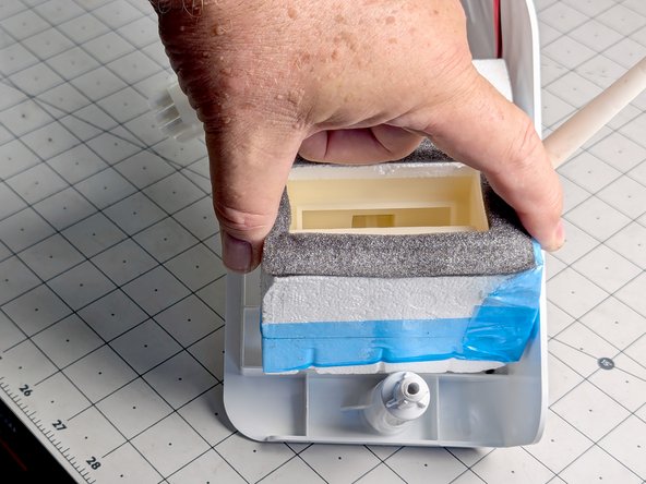

  10. Frigidaire Side-By-Side Refrigerator Freezer Thermistor Replacement, Lift the damper assembly: 手順 10、 2の画像 1 Frigidaire Side-By-Side Refrigerator Freezer Thermistor Replacement, Lift the damper assembly: 手順 10、 2の画像 2
    • Lift the damper assembly upward to access the blue tape holding the freezer thermistor.

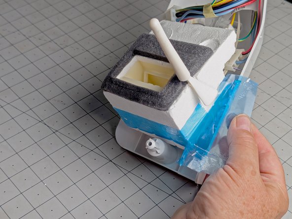

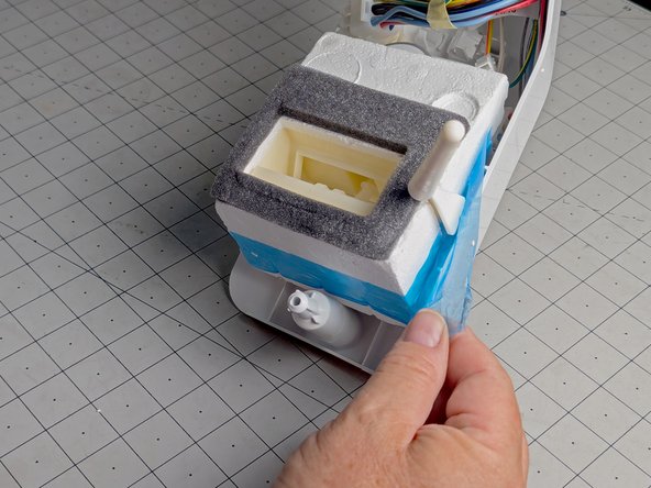

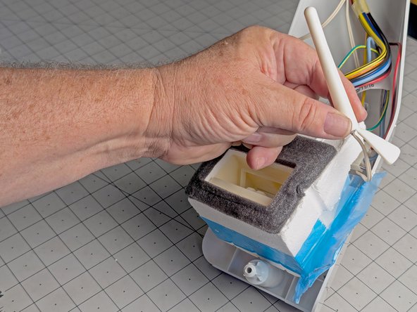

  11. Frigidaire Side-By-Side Refrigerator Freezer Thermistor Replacement, Release the freezer thermistor: 手順 11、 3の画像 1 Frigidaire Side-By-Side Refrigerator Freezer Thermistor Replacement, Release the freezer thermistor: 手順 11、 3の画像 2 Frigidaire Side-By-Side Refrigerator Freezer Thermistor Replacement, Release the freezer thermistor: 手順 11、 3の画像 3
    • Use your fingers to peel the blue tape securing the freezer thermistor.
  12. Frigidaire Side-By-Side Refrigerator Freezer Thermistor Replacement, Free the freezer thermistor: 手順 12、 3の画像 1 Frigidaire Side-By-Side Refrigerator Freezer Thermistor Replacement, Free the freezer thermistor: 手順 12、 3の画像 2 Frigidaire Side-By-Side Refrigerator Freezer Thermistor Replacement, Free the freezer thermistor: 手順 12、 3の画像 3
    • Grasp the freezer thermistor and pull it away from the foam damper assembly on the control housing to free the freezer thermistor from its location.

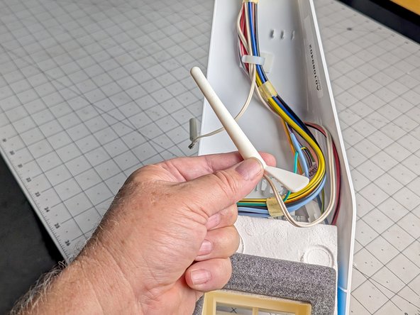

  13. Frigidaire Side-By-Side Refrigerator Freezer Thermistor Replacement, Release the thermistor leads from the harness clip: 手順 13、 2の画像 1 Frigidaire Side-By-Side Refrigerator Freezer Thermistor Replacement, Release the thermistor leads from the harness clip: 手順 13、 2の画像 2
    • Unclip the thermistor leads.
    • This applies to both the fresh food and freezer thermistor leads. In both cases they are white 2-conductor cords.
