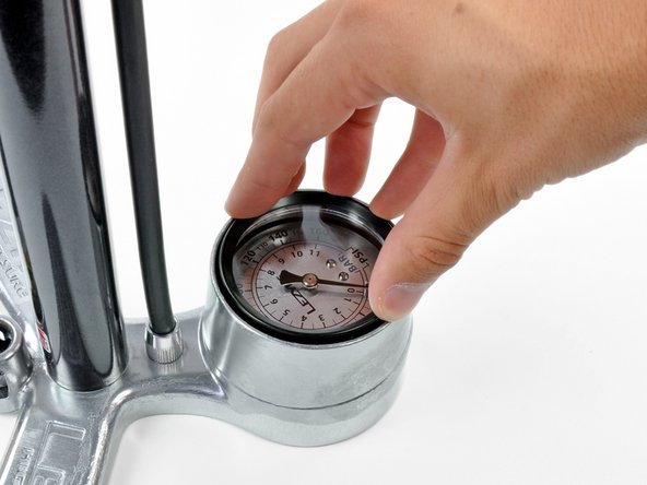

  1. Floor Pump Gauge Replacement, Removing the Gauge Cover: 手順 1、 2の画像 1 Floor Pump Gauge Replacement, Removing the Gauge Cover: 手順 1、 2の画像 2
    • Using a flat head screwdriver, pry up an edge of the gauge cover.
    • Remove the gauge cover.
